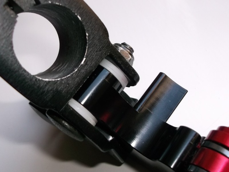

Well, there is good news and bad news.
The good news... The brake lever was installed in under ten minutes and fitted perfectly.
The bad news... The clutch lever pivot plate was too small, 5mm narrower than the standard lever. The standard lever is 19.5mm thick and the Chinese lever is 14.5mm thick. Also, the bushing that was included was too big for the 6mm pivot bolt that passes through it.
When I removed the standard clutch lever I found it didn't have a bushing - probably lost while it was with one of the two previous owners - so I didn't have the option of using that one instead.
I'm hoping that I have been given the wrong pivot plate by mistake and that they will send out the correct one. It has the number Y688 stamped into it which should help identify it.
I'll keep you updated, but right now I would not recommend that anyone buys these levers if you want a fuss free swap over. But, if you're willing to start adding shims/washers to either side of the lever - which I will probably end up doing - then go right ahead and buy some.
Edited: 10 March 2015. Adding shims for a perfect fit.
I decided to use nylon washers to fill the gap either side of the lever. I bought some M8 washers which gave me the correct outside diameter and then enlarged the 8mm hole to 10mm which is a nice fit around the brass bushing/collar. The washers were 1.6mm thick and had to be reduced to the ideal thickness. Using emery paper I reduced two washers to 1.5mm thick and two down to 1.0mm and then paired a 1.5 and 1.0mm together giving me a total thickness of 2.5mm. This has to be done for both sides of the lever pivot area so that the missing 5mm is regained.
I'm really pleased with the finished result!

That's something that crossed my mind also when I saw how far off spec the clutch lever was. :/ (the machining on it is a bit raf also)
I don't fancy the prospect of150 70mph and a handful of nothing at the end of it.
p.s. This might also be something worth considering when buying a used bike. Any aftermarket parts could look nice, but be very deathtrappy unless they have the docs to prove that they meet acceptable standards.
