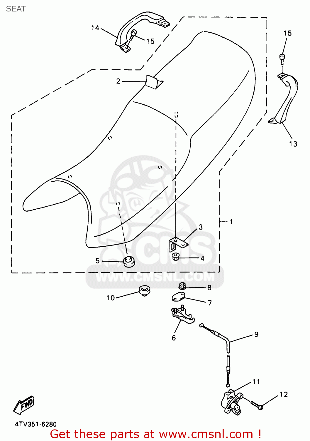

As this image shows, the lock is held on with two bolts (item 12). I just took a look at mine and they are easily accessible but are the security Torx type (so an internal Torx drive but with a raised centre, so a conventional Torx bit won't get in there). However, I reckon if you don't mind replacing them, you could easily have them off with some mole grips on the outer edge of the head. Once off, I suspect that if you pull the whole lock unit down it will pop the seat. 2 minute job with the right tools.

ah you have reminded me,, i used a piece of wire to snag the cable and pop the seat off then undid the security torx bolts (torx bits readily available from cheap places like halfords etc) then took the lock to locksmith, had it back the next day with 2 keys for 16.50

Thank you pete and weasley for excellent tips.If i get seat off then it will negate the need for keys Smile I dont suppose there would be a code on side of barrel for key ,as it would make it too easy for thieves
