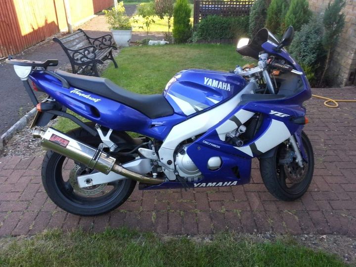

I bought my '03 Thundercat with around 12,000 miles in '08 or '09 as an upgrade from my GPZ500S. The Thundercat was my first proper big bike. I used it for my short commute in all weathers, including snow. After a while my old man decided to sit his bike test in retirement so I gave it to him while I did a DIY renovation on a house and started a family.
In early 2020 (pre-COVID) I'd arranged with my dad to get her back on the road and made space in the garage for her. He'd had two new hips so wasn't using the bike. Since the kids were a bit older I wanted to get it back over this side of the country and enjoy the fact I live close to some fantastic scenery and great roads. My dad took her for an MoT in March 2020 and it cut out 100 yards from the MoT Garage, not surprising after it sat in his garage for 5 years or so. He left it with them to get it running then promptly dropped dead unexpectedly. In May I went to collect the bike after it had the carbs done, new plugs and a general check over. It was a bit surreal on the 90 mile trip back. I had all my own gear on but my boots had been stored in a shed for 5 years and a small mammal had made them home so I was wearing my dad’s boots. I was in convoy with the Mrs and kids in the car so had plenty time to contemplate having big boots to fill and taking some comfort in the happiness I knew he had from borrowing my pride and joy.
So about the bike
She's got a double bubble screen, laser can, RG crash bungs, Scotoiller, Yacugar monoshock, braided hoses and Givi top box rack.
She’s in fairly good condition but I’ll be giving her as thorough a restore as time, expertise and cashflow allows.
No doubt I’ll be asking a few questions about sourcing parts and stripping/rebuilding soon enough.

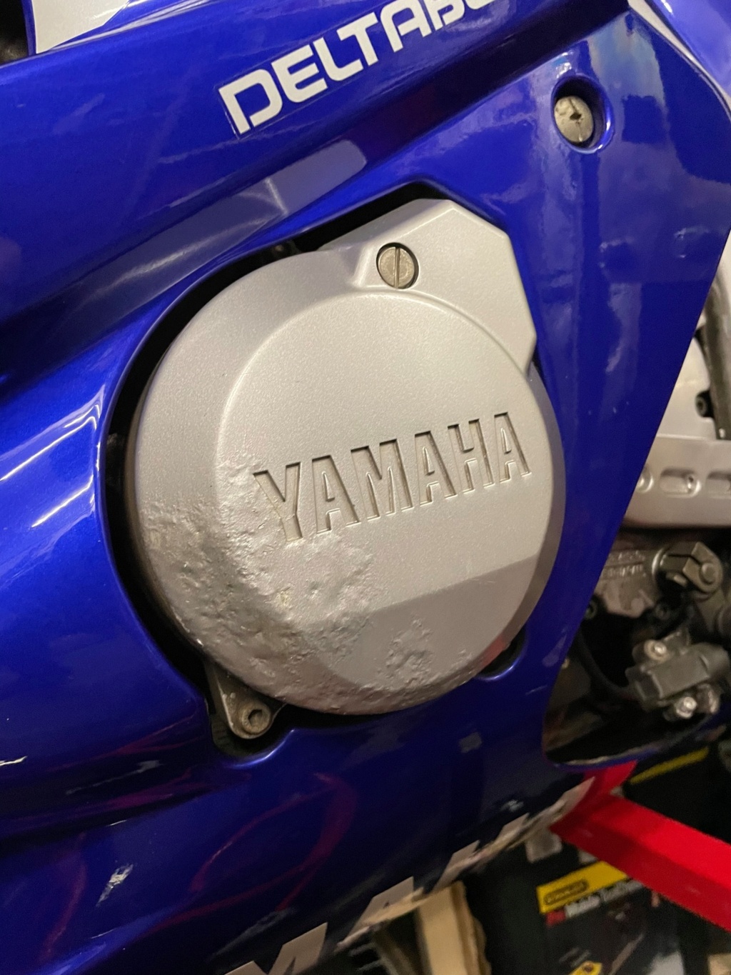

There's also a fairly horrific looking stator cover so I need a plan for that.

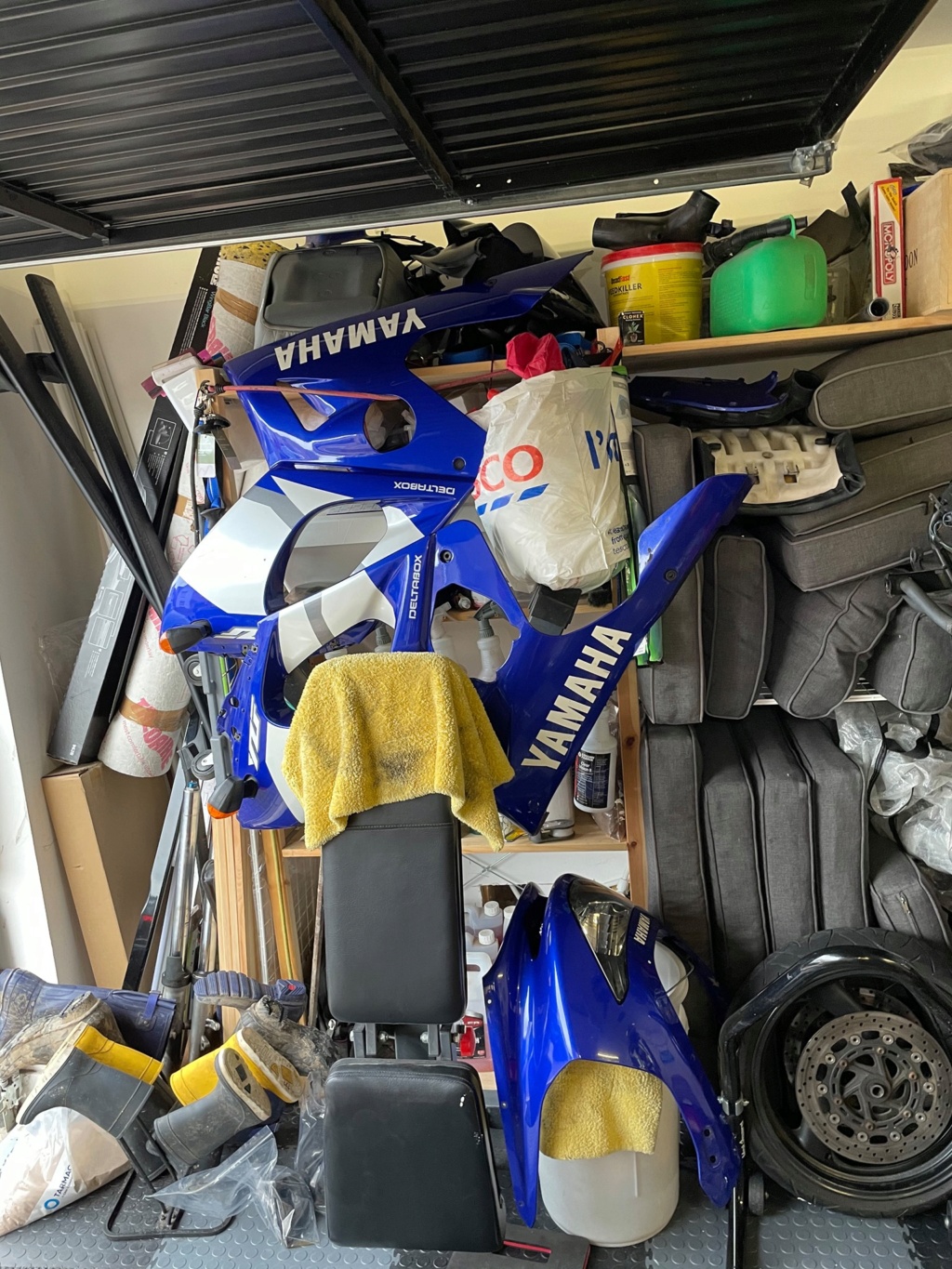

Things just stepped up a gear. Front end is off.
Bodywork set aside for more cleaning, correction and protection.

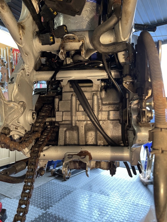

Any advice on how worried I should be:
I think the swingarm will need to come off but I'll need to re-mount the Skylift as it's currently on the swingarm mounts.
I removed the leaky shock, dog bones, torsion bar, caliper, etc.

So the Skylift is re-mounted using the specific swingarm removal mounts. You just remove a foot peg bolt and replace it with the fitting kit.
I had to put the monoshock back on and refit the rear wheel temporarily to facilitate removal of the Skylift. I also set a trolley Jack under the engine while the lift was off - this mean removing the radiator mount and exhaust.
It was fairly easy to remount it and get it up in the air. Wheel was quickly back off and relay arm too. I also got the under tray off after a bit of fiddling.

Alloy corrosion under the paint and probably looks worse than it is. Sand down and repaint.Nanoman wrote:There's also a fairly horrific looking stator cover so I need a plan for that.
Nanoman wrote:...I'm not sure this is supposed to fall out the swingarm.
Flakes of rust? Make a homemade scraper of some sort to give the inside a good clean and then spray some cavity wax inside to protect it. I'll be treating my swingarm to some Dynax S50 which I bought for my 30 year old Toyota Celica, but there are similar treatments out there.
Guess it's too late to mention this, but you could have fitted the R6 shock with a Lewis Fabrication adapter.Nanoman wrote:...ordered a new YSS monoshock with uprated spring...

When I dropped the engine off the guy showed me the difference between vapour blasting and soda blasting. He spent 3-4 minutes vapour blasting the thermostat housing and the results were astonishing. It strips metal but doesn't damage other components.
Unfortunately if the vapour blasting media gets in the engine it's catastrophic so you need to completely dismantle the engine and get the major components done separately. I don't have the expertise or time to do that myself and my local technician tells me the engines are bomb proof so it's not likely to achieve anything.
The guy sent me a couple of pics so I added Simoniz matt silver engine enamel to my paint order along with VHT black for the radiator and aluminium silver for the subframe.
There's an order of Bilt Hamber goodies on the way to treat the surface rust on subframe and some primer before I paint it. None of it will be visible but I want to use the opportunity to tidy it up while I can.
In other news I've spent a fair bit of time further stripping down components and documenting what went where so I've got a better chance of putting it back together again.
As I've been dismantling things I've been sorting the bits which are getting re-plated in a selection of zinc coatings, mainly yellow zinc, with some major components black zinc and a few pieces probably going with clear zinc.
It's a much harder decision than you'd expect! I'm not sure how it will all come up at the platers so I might have to rethink once I've discussed it with them.
I dropped off the relay arm and swingarm at my local garage to get some bearings removed. I got two out but there's another six which are more difficult to remove and I don't want to make an **** of it.
Calipers and forks are with my friendly local bike technician for stripping. I'll collect the caliper bodies and fork legs then get them off for powdercoat along with the engine covers, swingarm and relay arm. I'll add the engine cover fasteners and a couple of metal oil pipes to the relevant pile to go off for re-plating then I'll get on with what I can until bits start coming back from the relevant specialists.

I left the engine at the soda blasting place and they've spent a bit of time doing what they can with it. I didn't really have expectations that the finish would be anything to write home about and was content with the fact it would be an excellent base to paint over, if nothing else.
