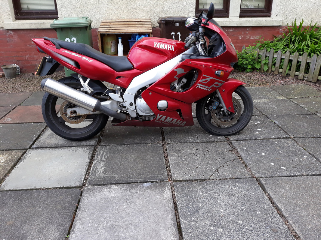

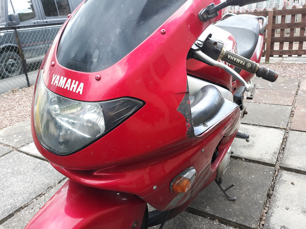

So. I have a cat
Now it look not toooooo bad from there but........

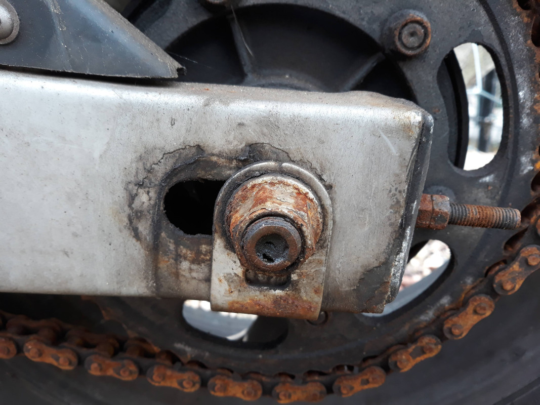

I knew it needed a chain and sprocket kit but never expected anyone to leave it to get this bad
Look at the adjuster

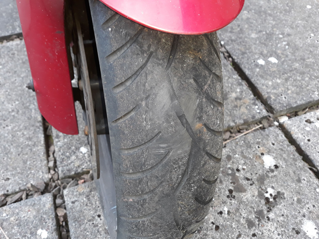

Front tyre may explain why he wend down on a roundabout

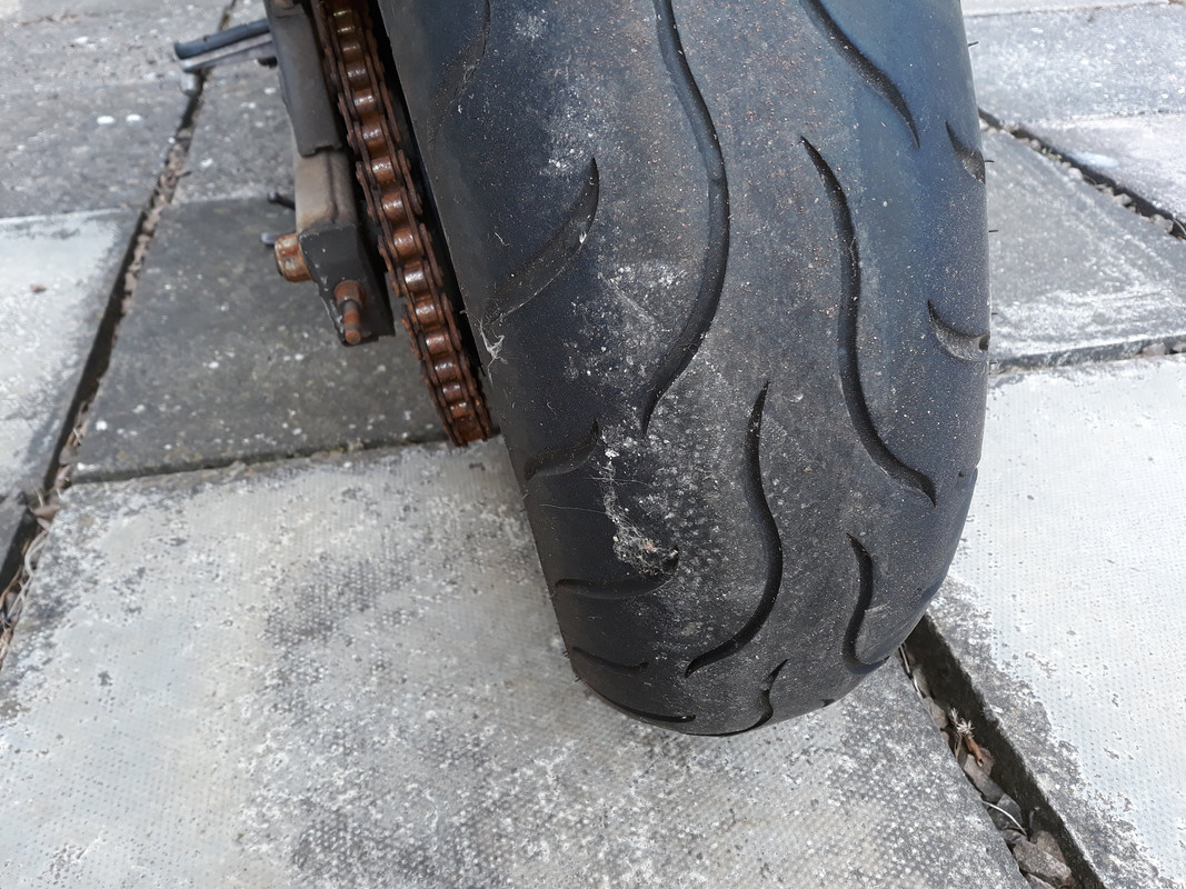

Back

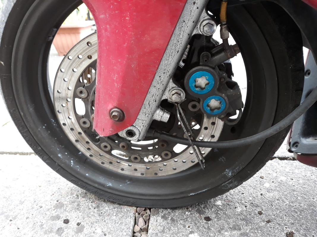

Disks are not to bad, ever slight lip so they are on next years shopping list

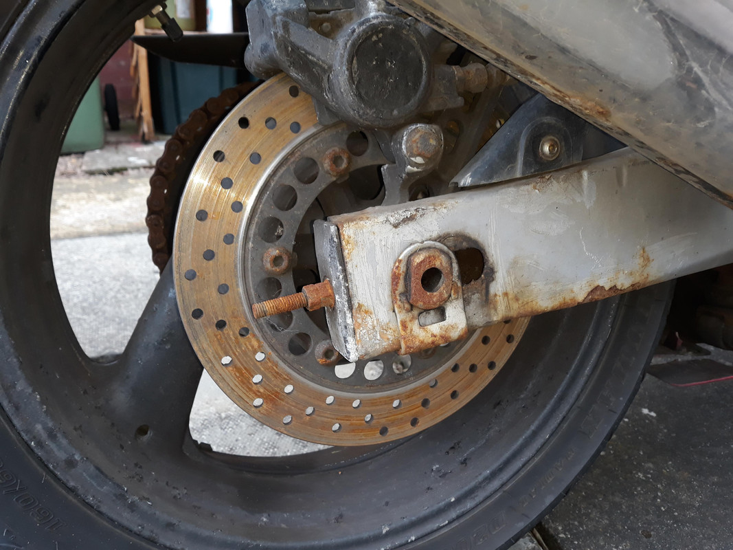

Back is surface rust but... Is that caliper hanger buggered? Just noticed the lack of metal holding it to the spindle

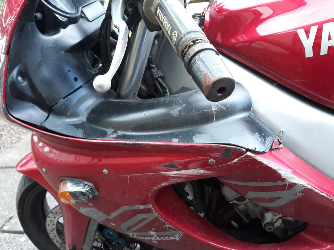

Bodywork

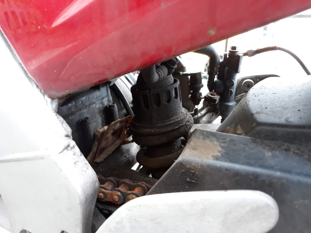

Now is this cam chain and is there any known issues with adjusters being crap? Bike is around 36k so thinking just a stuck adjuster
Back

Bodywork

Doesn't sound like cam chain, more like possible down pipes blowing and a misfire. Check your carbs, might just be dirt in them. As for the caliper carrier, not that good a photo but it looks ok. Just check it when the rear wheels out, if you can get the spindle out of course,

It doesn't sound like the cam tensioner to me. As far as I know they didn't suffer tensioner problems like the later bikes do ( my Tracer had a failing tensioner).
My second 'cat sounded a bit like that, maybe not as bad initially. In my case it was a loose spark plug, it did sound like an exhaust gasket.
However mine was never a happy bike and in-spite of my local spanner saying he'd cleaned and adjusted the carbs, even a second opinion said the same and the Yamaha dealer refusing to look at it, oddly when I chopped it in at the Yamaha dealer - they fixed it. It was the carbs, a previous owner had twisted every screw they could find on the carbs.
I take it that it's been standing for quite a while, so the carbs would need a good cleaning, the calipers will also need a service.

As it's been dropped hard, it might be a idea to remove the handlebar grips to check if the bars are bent or cracked. Had a bit of a shock when I checked mine.

Bike is looking a bit neglected (left in the rain) unfortunately, rear sprocket is shocking (front probably as bad).
It's so hooked the chain is starting to ride over it and the chain is so stretched that the tensioners can't handle it even after being wound out to the max.
Easy way to check the handlebars is to go full lock both ways, there should be a gap between the bar ends and the tank (so you don't get a hand trapped if you drop it).
Discs will probably clean up with use though.
