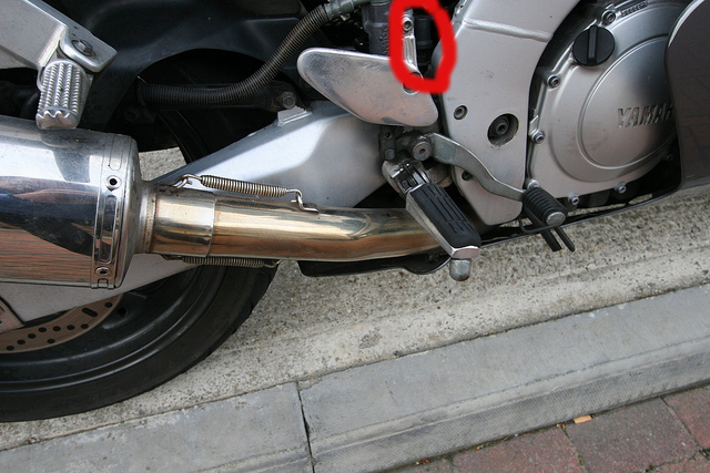

Muchas gracias a todos por el recibimiento en este foro, quisiera preguntar una cosa, la luz trasera de mi Thunder no se enciende (la de freno si). le cambie la bombilla por una nueva y despues le mire todo el cableado y esta todo bien pero sigue sin encenderse la luz de posición ¿les ha ocurrido alguna vez esto en sus motos? y ¿que solución hay?. Siento no expresarme en inglés pero más o menos entiendo un poco de el aunque no lo escriba. Muchas gracias de nuevo. Saludos en Vssss...

Adjust the rear brake switch, check the link between the switch and the brake lever. You will see the pin move out of the switch when you press the brake lever.Juan-figo wrote:Thank you very much to all for the welcome in this forum, I would ask one thing, my Thunder backlight does not light (the brake if). you replace the bulb with a new one and then you look at all the wiring and everything is fine but still does not turn the light position would you this has ever happened in their bikes? and what solution?. Sorry I did not express myself in English, but more or less I understand a little but do not type the. Thank you very much again. Greetings

Gracias por atenderme, pero la luz de frenado si se enciende la que no se enciende es la de posición...Saludos...

There is a spring that hangs below the black unit in the picture.
With the ignition on pull this spring down gently and the brake light should go ON.
Be careful it doesn't fall off the mechanism at the bottom as it is awkward to put back on.
You probably just need to tighten the black plastic nut. It happens to mine all the time and I've just recently stuck some tape on it.

Gracias otra vez Mr. Rosco, pero mi problema no es la luz de frenado, es la luz de posición del piloto trasero, le cambie la bombilla y le revise todo el cableado pero sigue sin encenderse...

Do you have a small light in the headlight? If so does that come on when you put the light switch into the first position?
Turn the bike off with the key and then push down and turn to the left, this should put the park light on in the tail light as well as the small light in the headlight reflector (if you have one).
It is possible you could have a problem in your ignition switch, but first lets see what happens when you try the above.

Ya tengo localizada la averia, es la llave de ignición completa, ahora me falta saber donde puedo conseguir una nueva o usada. Gracias a todos...
