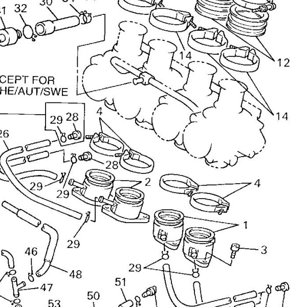

So. What I've learnt today, is Yamaha don't like making things easy to do. Still can't get the Damn carbs off

Re: 33bhp :(
I have the opposite problem of keeping them on!
You having problems undoing the lower clamps (marked 4 in the diagram)? I was able to loosen the clamps enough to be able to move the clip into a better position to get the allen key in easier.
Number of posts : 5102
Re: 33bhp :(
Yeah, the clamps are incredibly hard to get at, I've finally done it and was pleasantly surprised out how nice if runs restricted, much nicer ther my cb500 haha

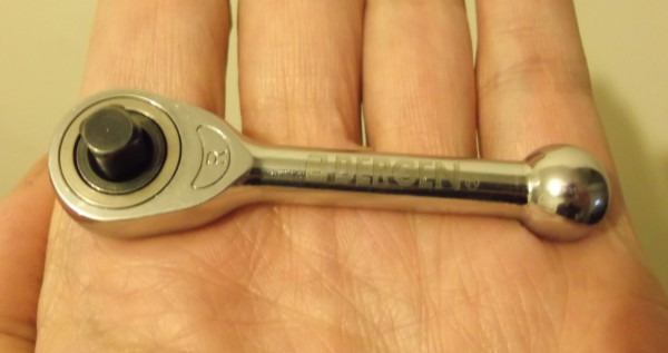

This little quarter inch drive ratchetless wrench is one of my favourite tools. It gets into all sorts of awkward places.fr3tless wrote:Yeah, the clamps are incredibly hard to get at...
I'm glad you got it sorted.
