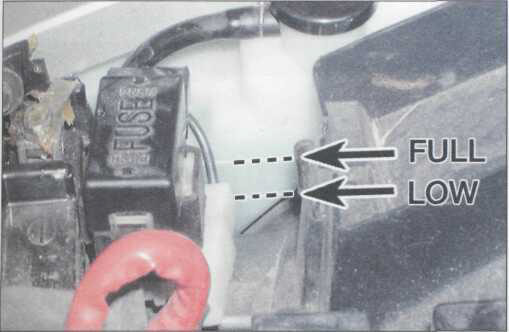

The expansion tank has  upper and lower level markings
puddle of coolant Coolan10
looking at the picture it was overfilled as it is still just above the full line , so the level when cold is about an inch below the overflow pipe in the neck of the tank and when hot rises up a bit, no water lost today . fingers crossed it was just topped up too much.
