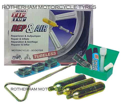

Puncture Reair Kits
I have nearly always carried the tip-top repair plugs with 3 CO2 canisters, small enough to fit under the seat. This is what it looks like.
Felt fairly comfortable knowing it was there for when the dreaded puncture strikes. A couple of months ago it happened, I wasn’t that far from home so decided to leave the flint in and hoped for the best. Turned out to be a very wise decision, got home OK – left the tyre till the next day to fix. By then it was fairly deflated. Got out the kit and set about plugging the hole. Well either I’m an idiot and don’t know to use it, or possibly it’s the lack of strength in my right shoulder but I couldn’t get the plug in. Broke the first side, tried the other, nope same thing, tried another plug and the same thing; just as well as I didn’t try it where I discovered the flint in the tyre. Trying to read the instructions was a disaster, in spite of the kit being in a plastic bag, water had got in and the folded pages stuck together.
I set about replacing the kit, hoping to find a better way of plugging. Whilst I was researching, I found out the CO2 canisters don’t hold as much as I was led to believe – I’d need 6 of them to get the right pressure in the rear – yet again another fail for this method.

Re: Puncture Reair Kits
Loving the euphemistically named "special cement" in the first kit.
...although given your review on its effectiveness, you'd probably be as well jizzing on the puncture for all the good it does.
You right Alan, although it may not be practical doing a repair like that in public.
I found the cement to get all over your fingers and make a right mess, another fail from me on that kit. I only went for it because the RAC used a similar system and BMW re-badged it and included it with some of their bikes.
Steve,
I had something similar to your first kit (without the 'special cement'!!), however my kit had things which looked like plastic keys, except the key part was like a screw... which you used to plug the offending hole. I found these MUCH easier to use, you just put the point of the key into the hole and screwed it down until you got the fob part. This was then flexed back and forward until the fob part snapped off, leaving the plugging screw bit in the tyre. Nice and easy for a girl like me to use.... bonus! Unfortunately they seem to have changed the kit....and now they don't come with the key things, but with some kind of furry pipe cleaner type thing (as you can see, I'm not feeling so confident with my ability to use this should a dreaded puncture happen!).
Also, I thought that the CO2 canisters were basically enough to get you to a garage where you could top up the air as required? But maybe I was just plucking that from nowhere?
I got a Tip-Top kit some years ago - this used to be the marque of choice when tyres had tubes - though I admit I've never tried to use it. I have recently heard of other people who had difficulty getting them to work satisfactorily.
Then a few years ago when I picked up a puncture in France a guy I was with insisted on repairing it with his Stop & Go kit. I was dead impressed by how easy it was compared to one that uses gooey stuff, so I bought one (from Busters - just the basic kit without a pump).
That was the irony of the tip-top repair failure, apparently I hadn't made the hole big enough but when the tyre dealer came to plug it the 'cold' method didn't work because the hole was too big ! The 'hot' repair did work though.
