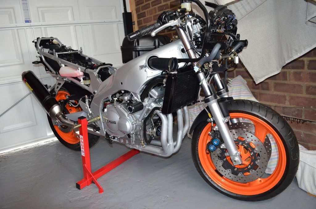

Here is a picture of my Thundercat I purchased in April 2012, it had only done 2400 miles.
I have almost stripped the bike right down, apart from taking the engine out of the frame. I have had various parts powder coated: Swingarm, relay arm, connecting rods, rear brake caliper bracket, torsion arm, clutch cover, sprocket cover, starter clutch cover, generator cover, etc.

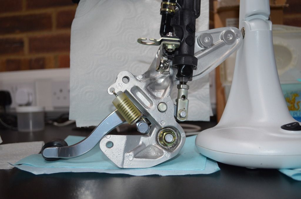

I have fitted new bearings & thrust covers to the swingarm, and cleaned & re-greased the relay arm bearings and fitted new dust seals.
Here are some before and after pictures of the swingarm, relay arm and connecting rods.
I have had the rear shock absorber rebuilt the spring powder coated and re-plated by brook suspension.
Here are some before and after pictures.

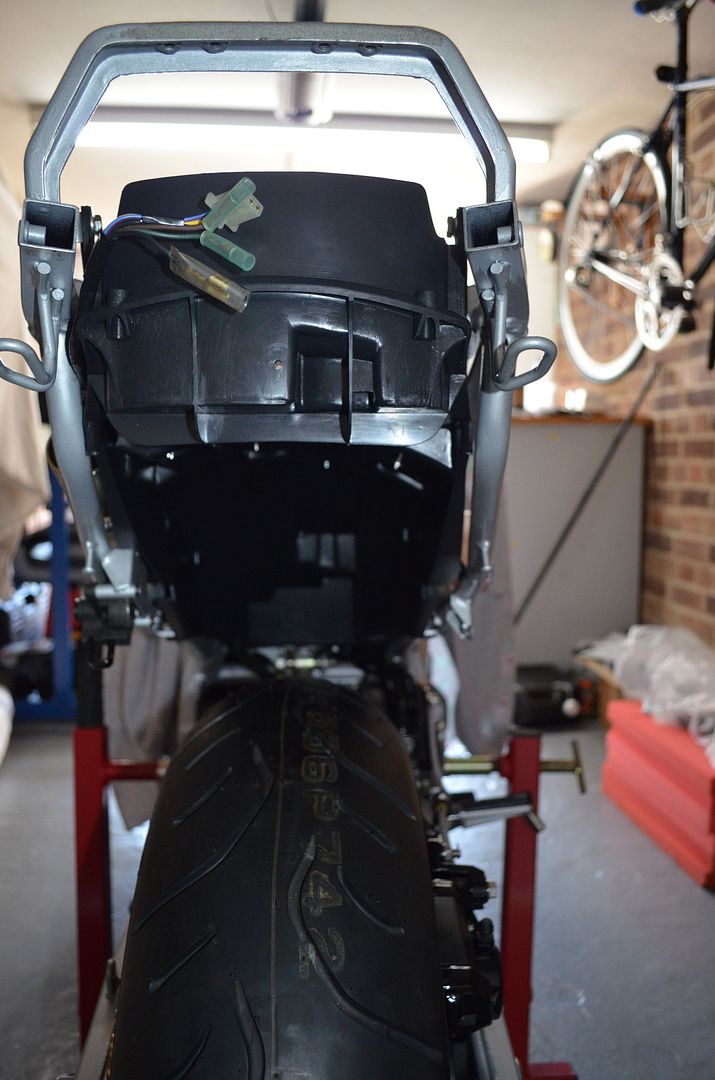

I have cleaned up the rear of the frame, removed all rust and cure rusted & painted with hammerite silver smooth finish.
Before.
After.

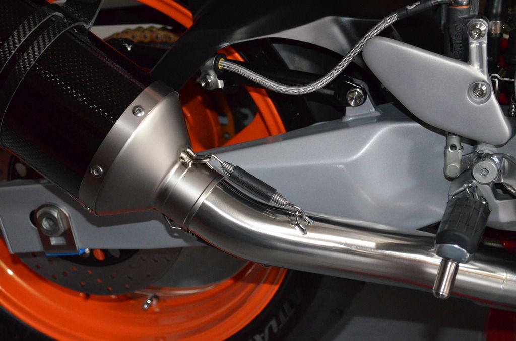

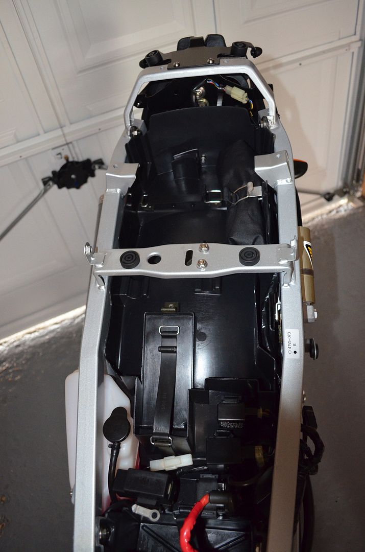

Re: Some TLC for Thundercat

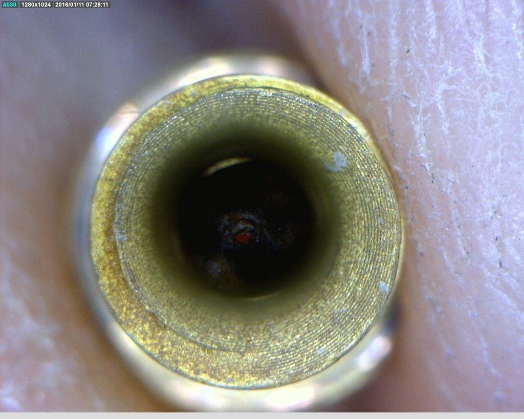

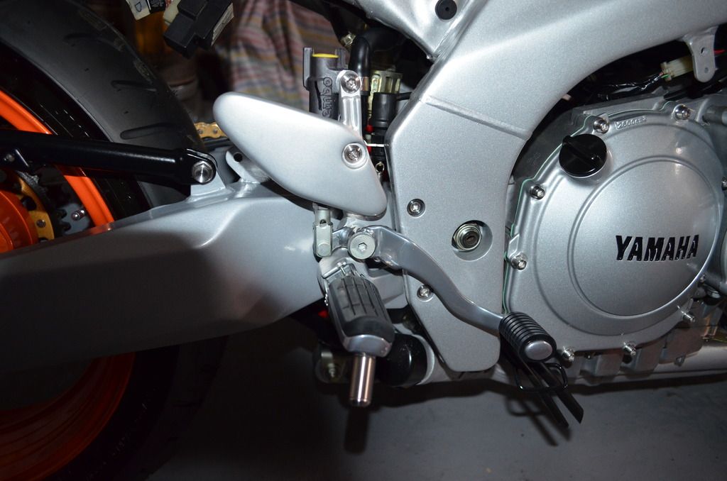

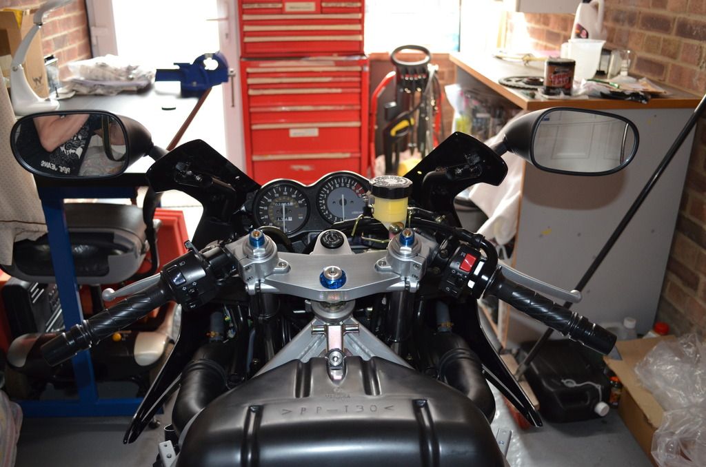

Sorry it’s been a long time since the last update, but my disabled son  got excluded from his school last year and myself and my wife had to find him a new special school that could cope with his issues (Autism, ADHD, Severe learning difficulties and Global developmental delay). We found him a new school , which is about 40 miles away from home and he seems much happier there. He lives at his new school and comes home every three weeks at the weekend. I blamed myself for this and I lost interest in quite a lot of things including getting the bike finished, I have now started to work on the bike again and hope to have it finished by the end of April.
I also had a couple of issues with the bike:
Fuel pump was leaking.
One of the down pipes was not getting as hot as the others.

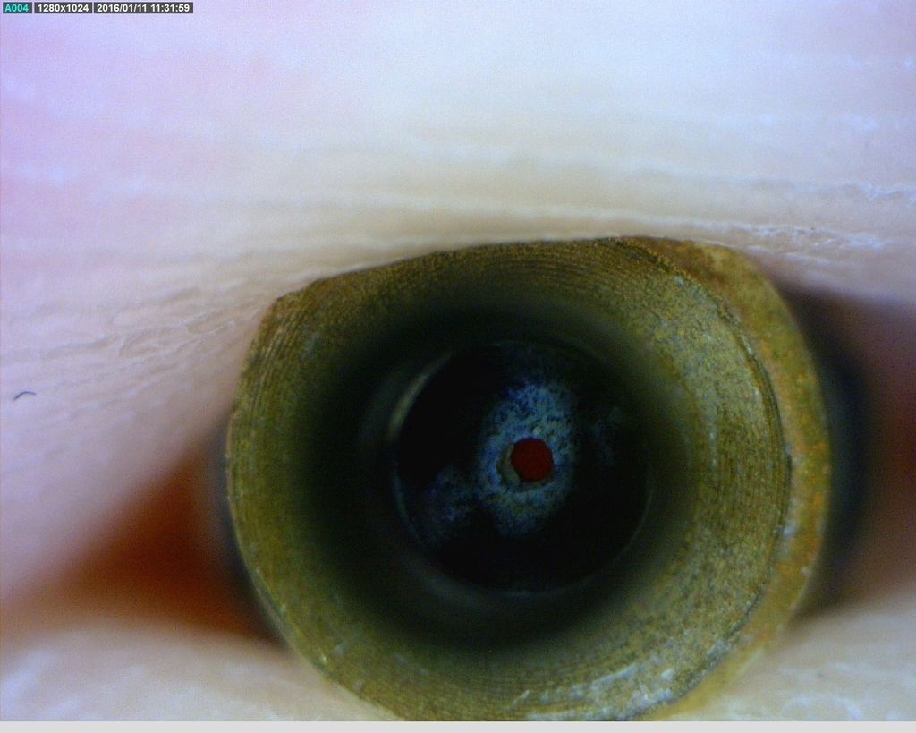

Fitted a new fuel pump. I purchased the new fuel pump from Fuel Performance Ltd, which has a lifetime guarantee and is made by High Flow.
I cleaned the pilot jet in the carburettor, (which looked partially blocked) to cure the issue with the down pipe.
See pictures below of what has been done to the bike.
Before cleaning.
After cleaning
Before
After
Before cleaning.
After cleaning
Before
After

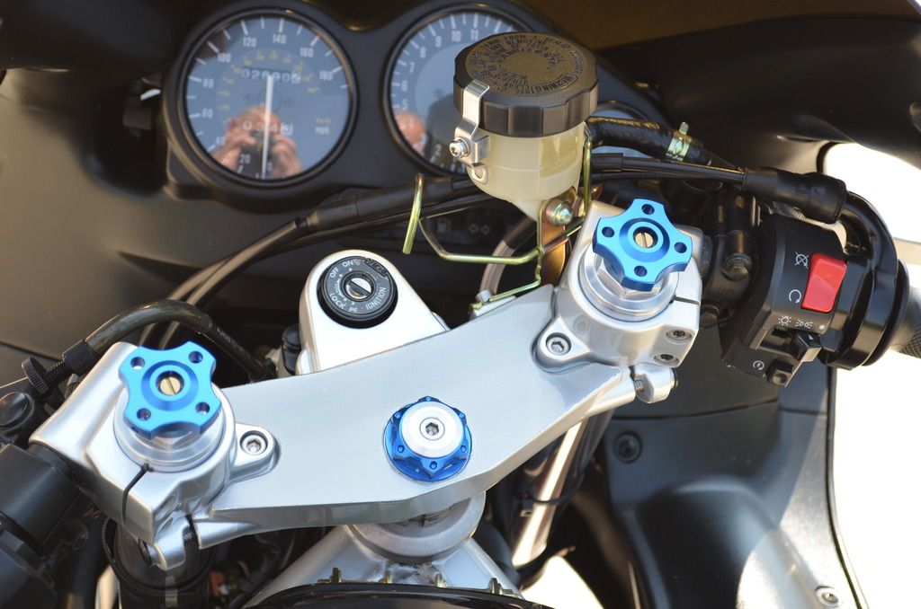

Glad things are on the up with your son,
What did you do with the top yoke???
I've tried polishing it but not getting anywhere with it??
Catnapper wrote:Glad things are on the up with your son,
Thanks.
I used wet and dry and scotch brite to get the finish on the top yoke, and had it painted on the bottom and around the sides & then laquared all over.
Nigel T/Cat wrote:Catnapper wrote:Glad things are on the up with your son,
Thanks.
Thanks for that. Need to be a bit more aggressive lol

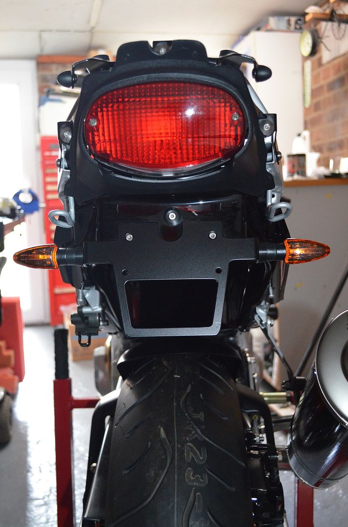

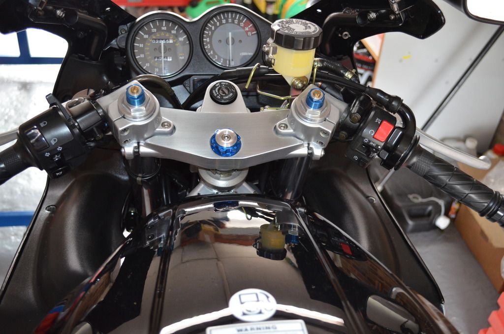

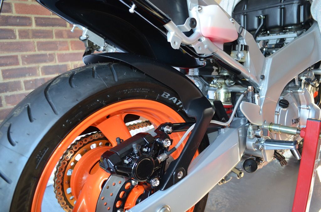

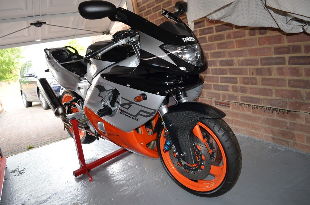

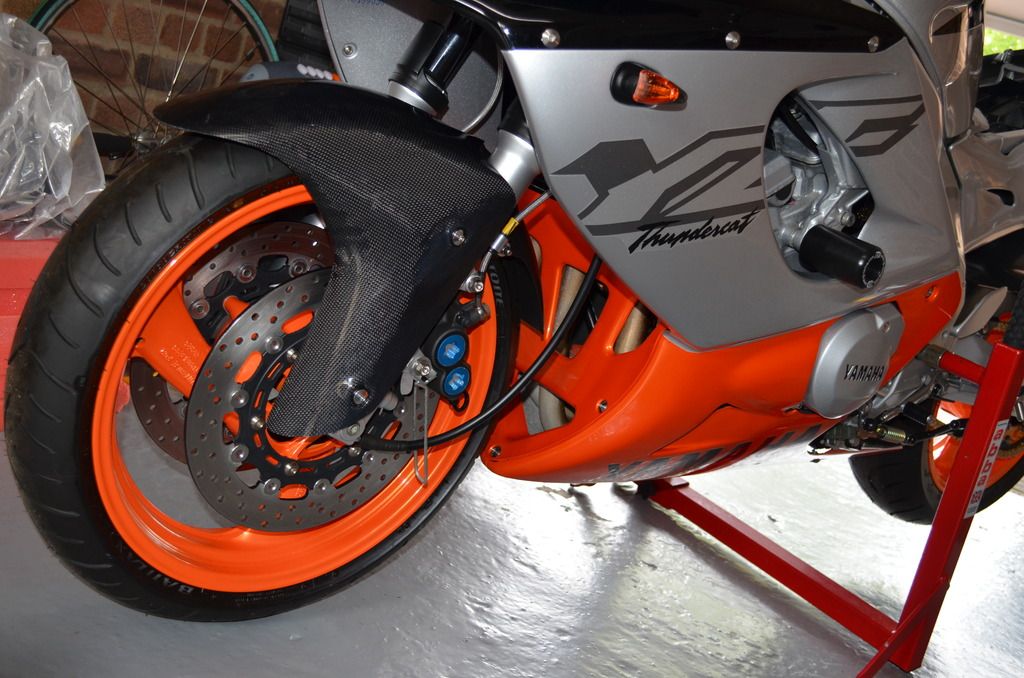

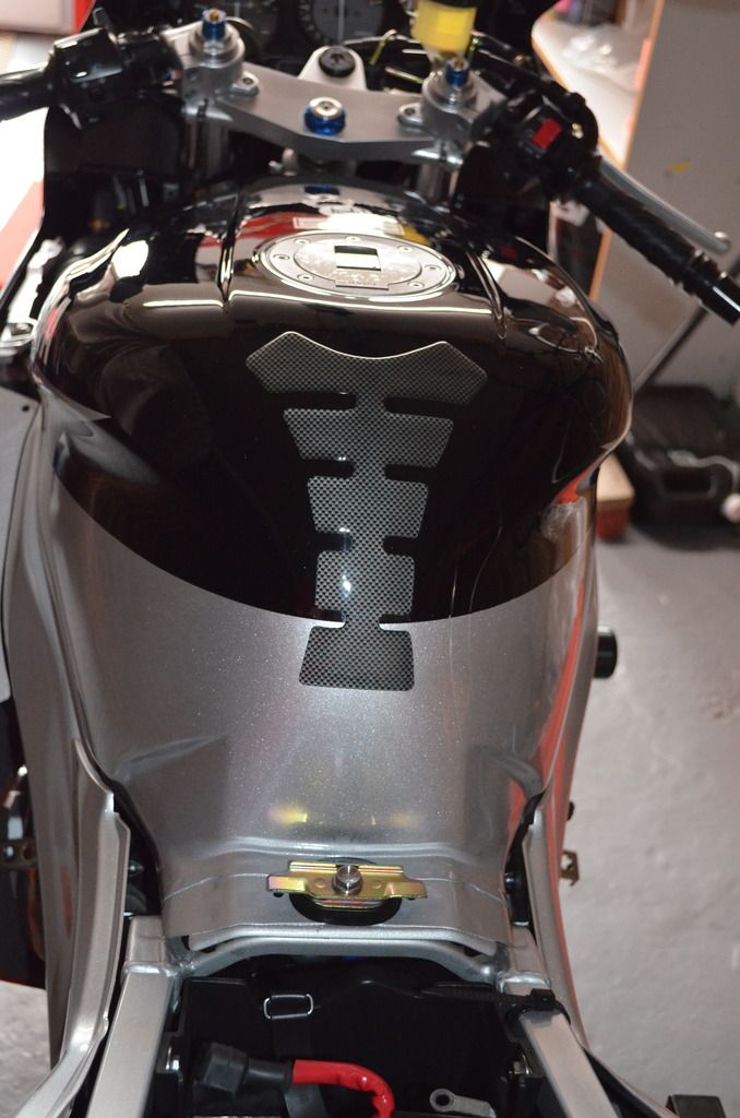

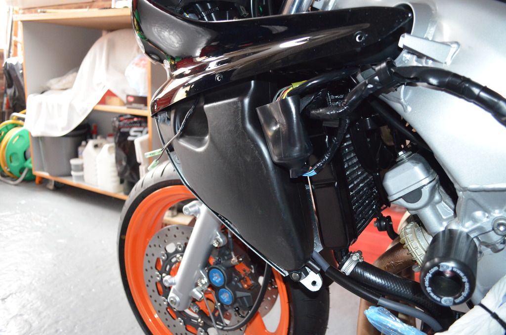

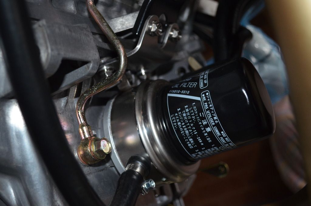

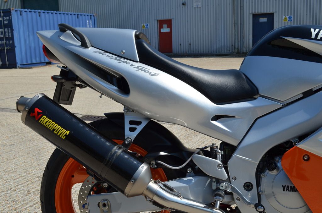

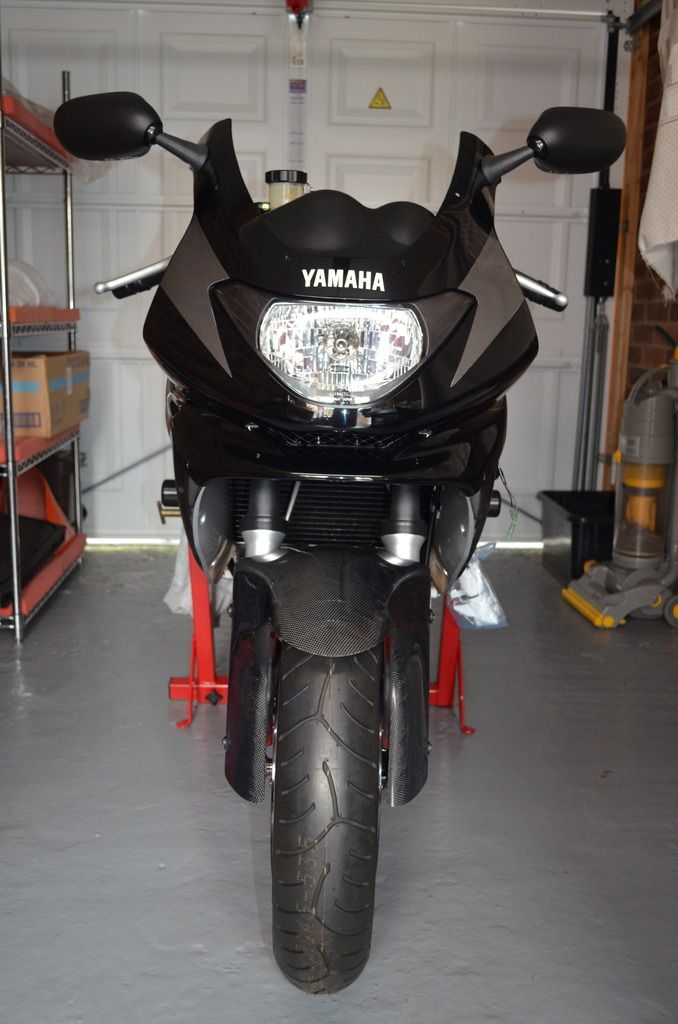

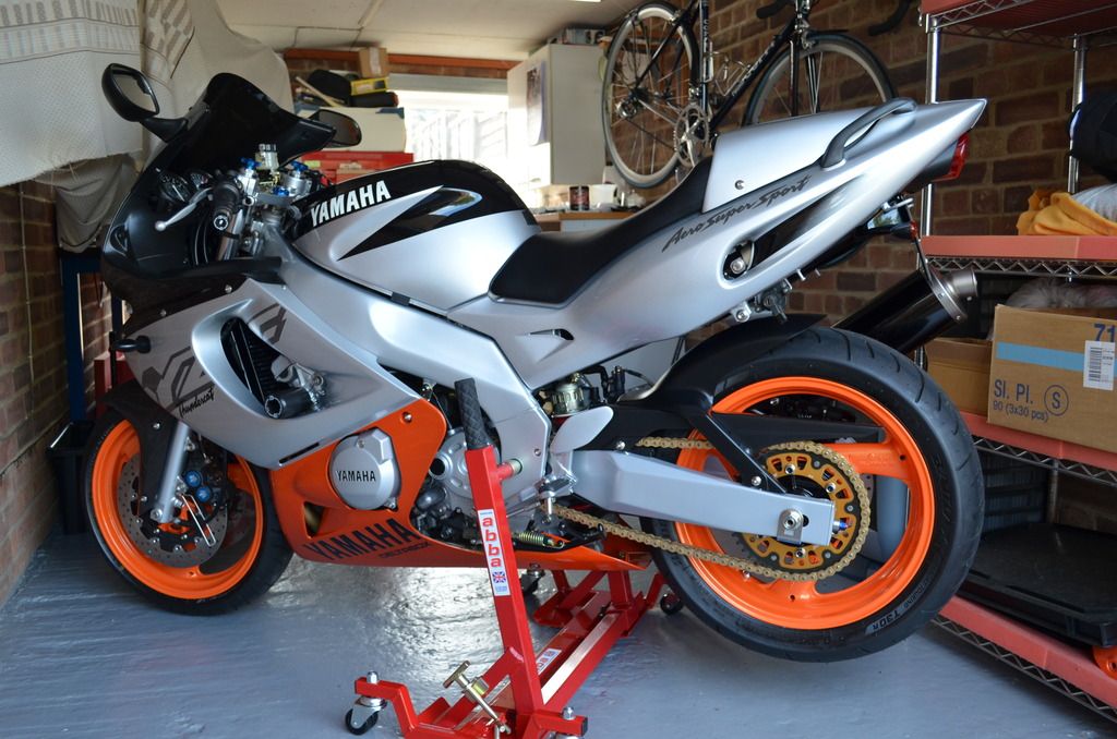

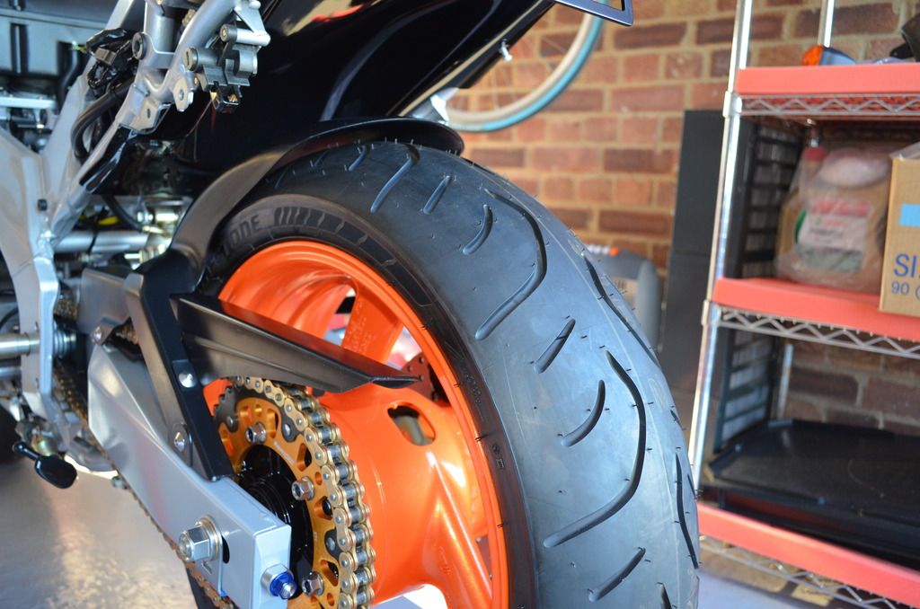

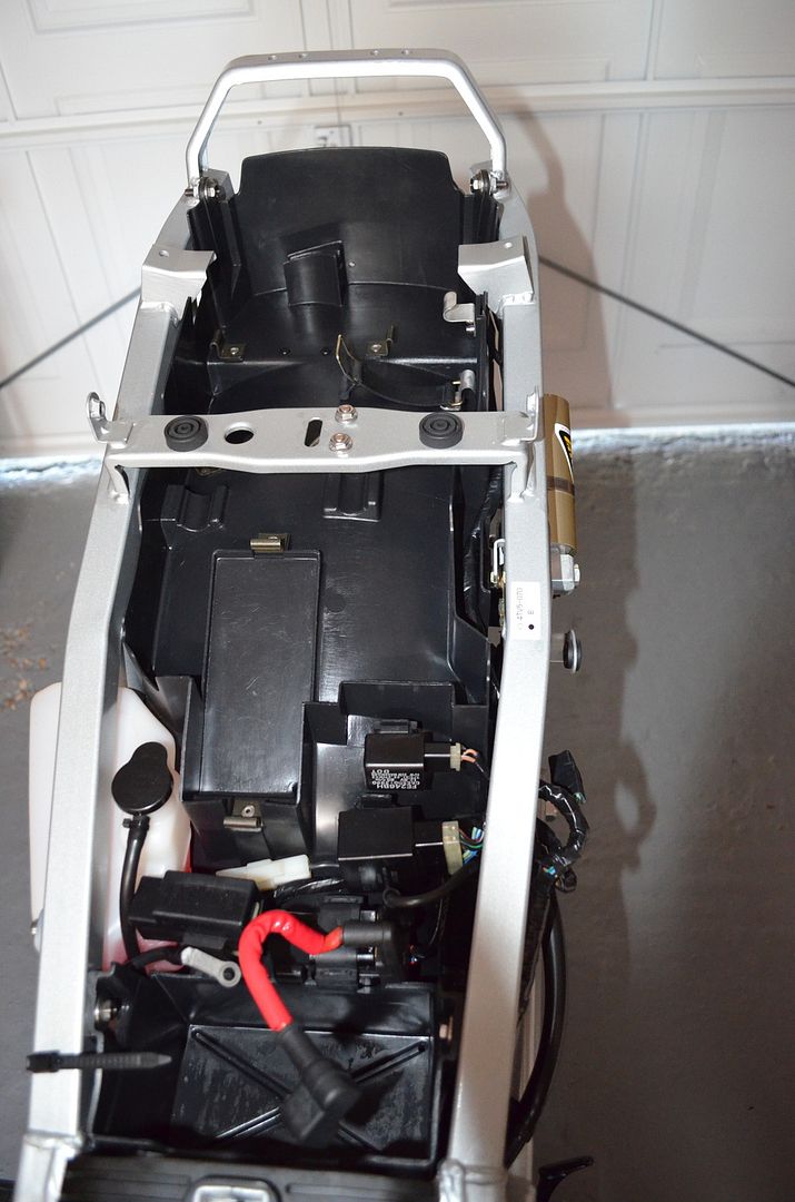

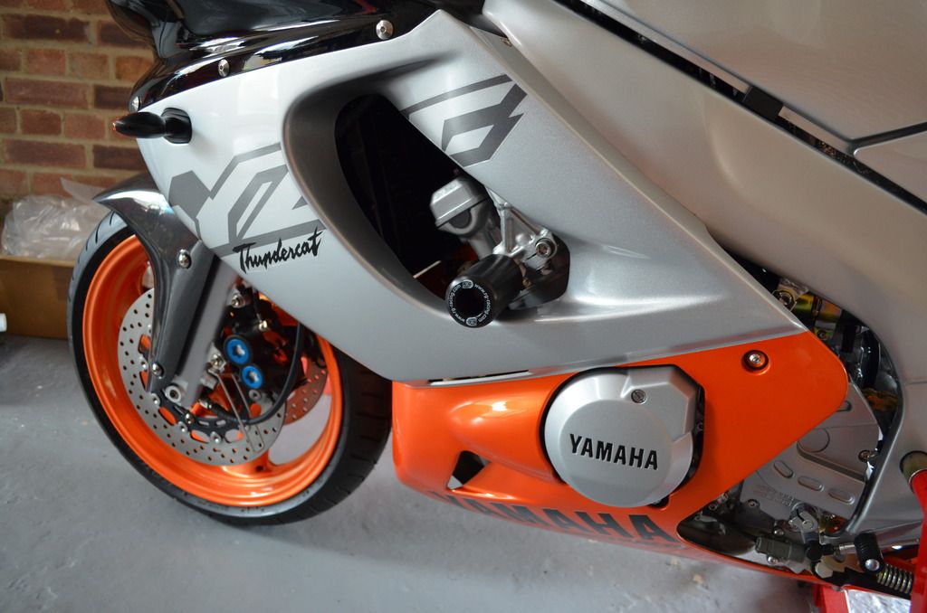

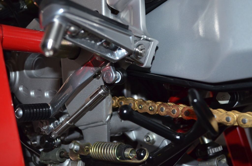

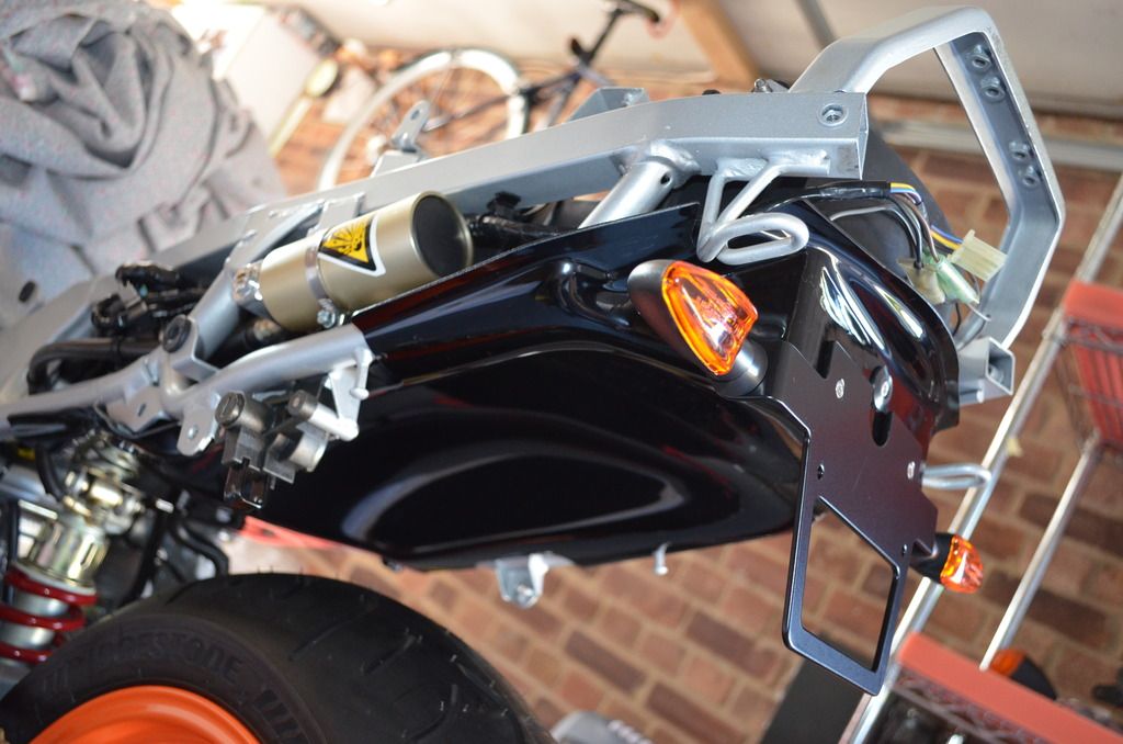

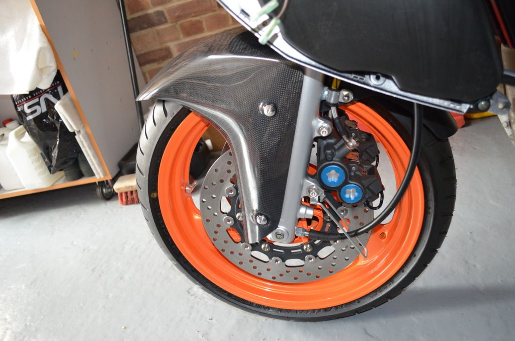

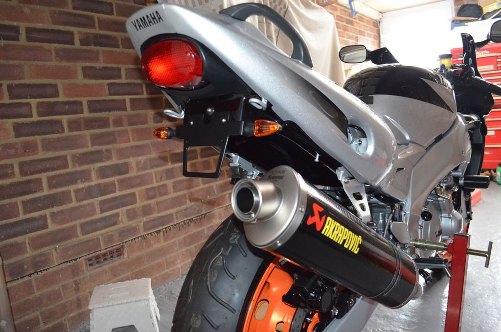

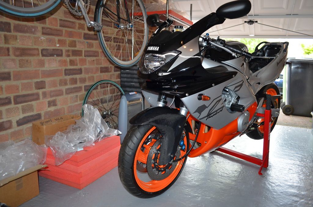

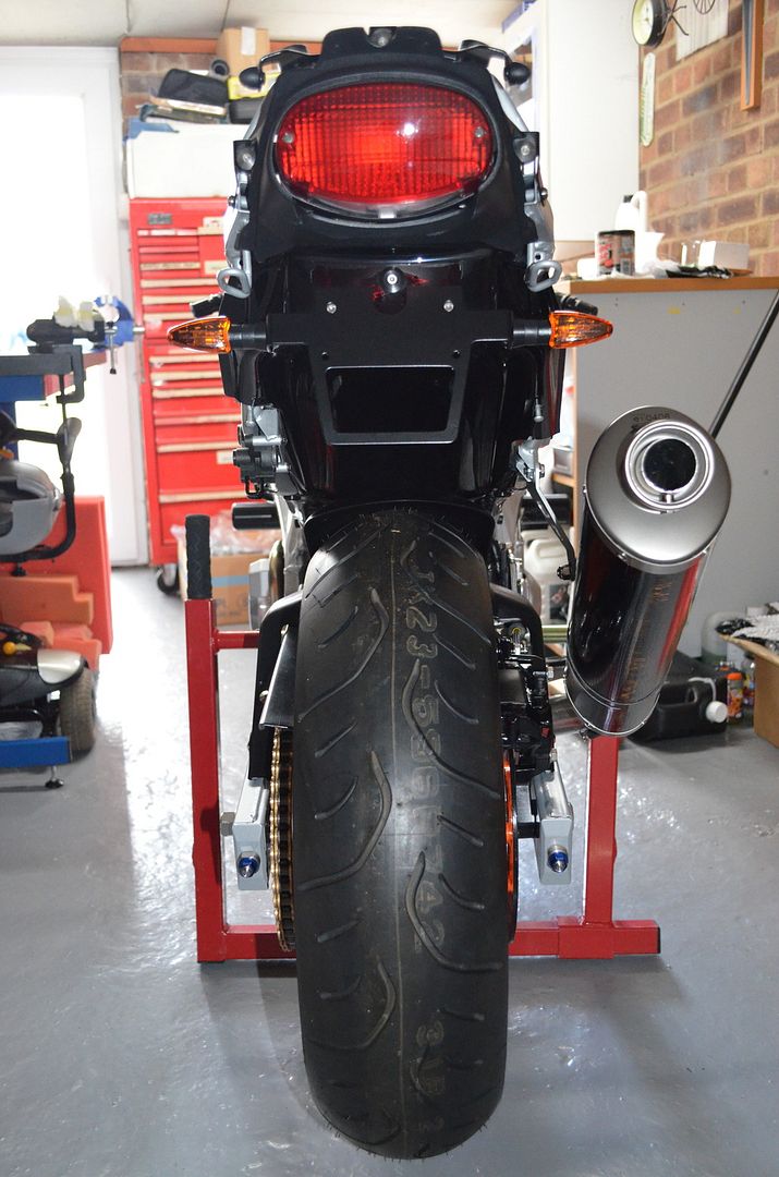

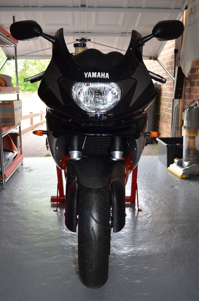

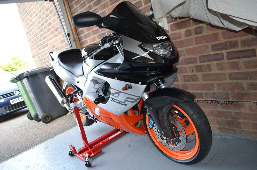

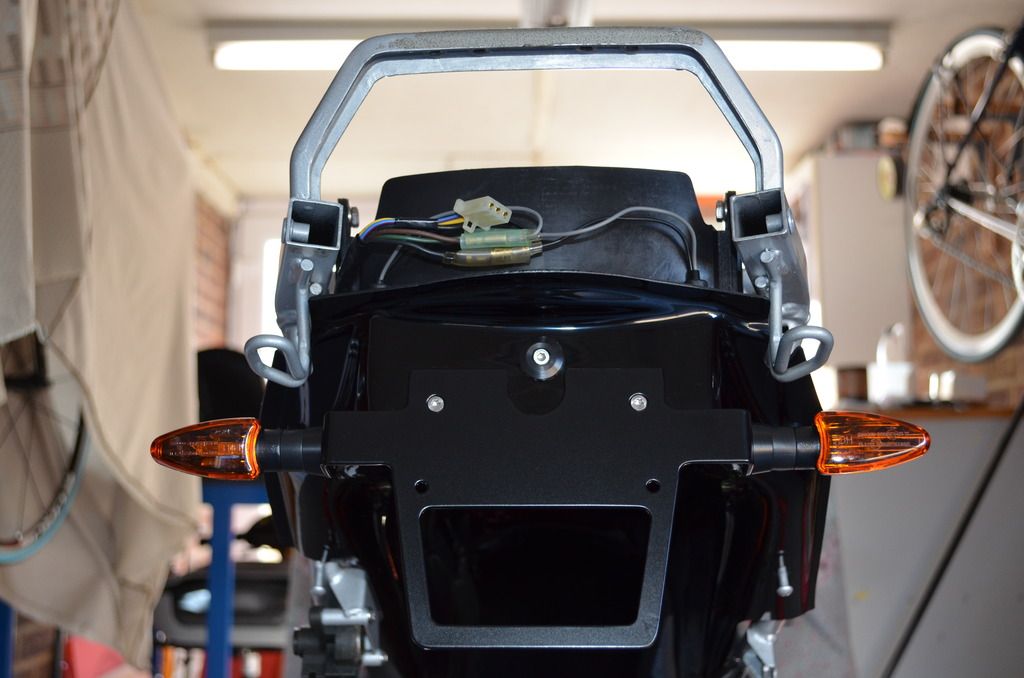

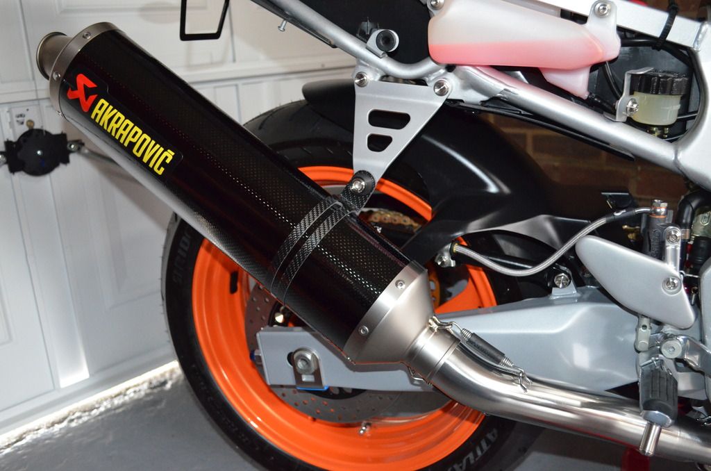

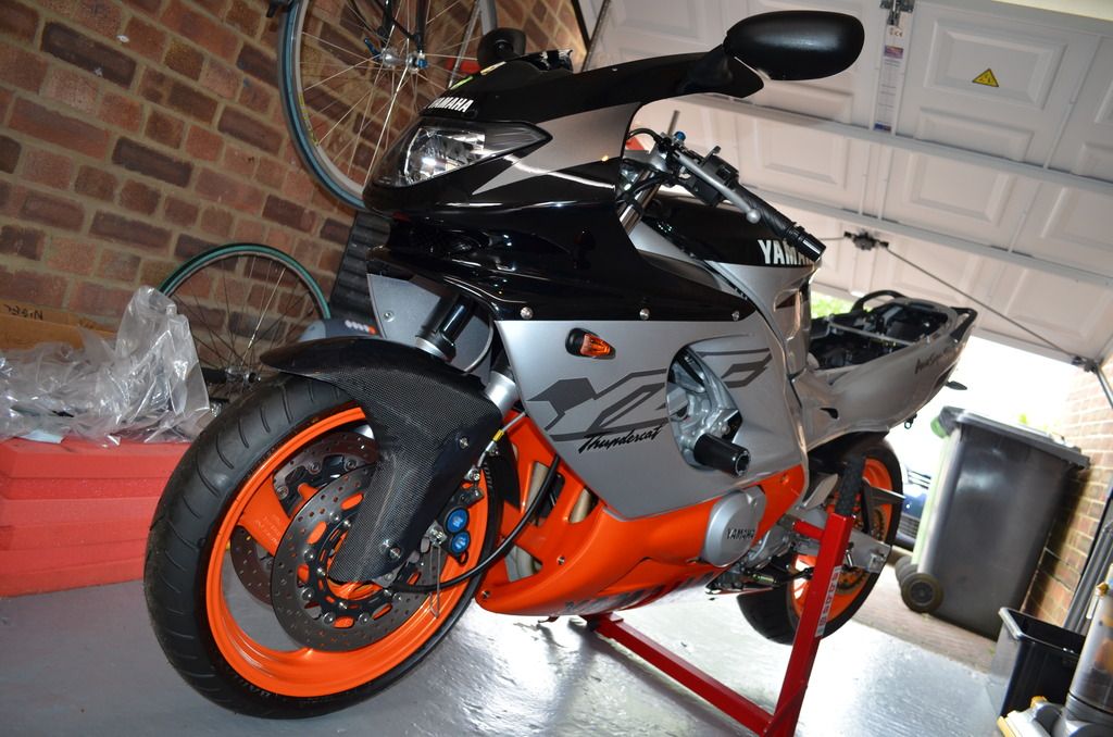

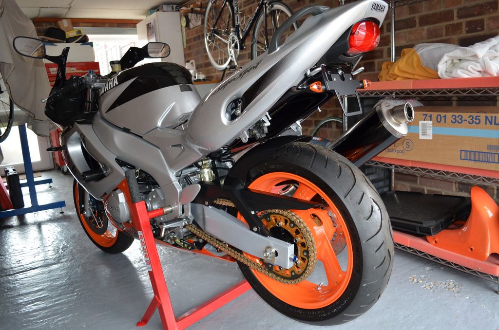

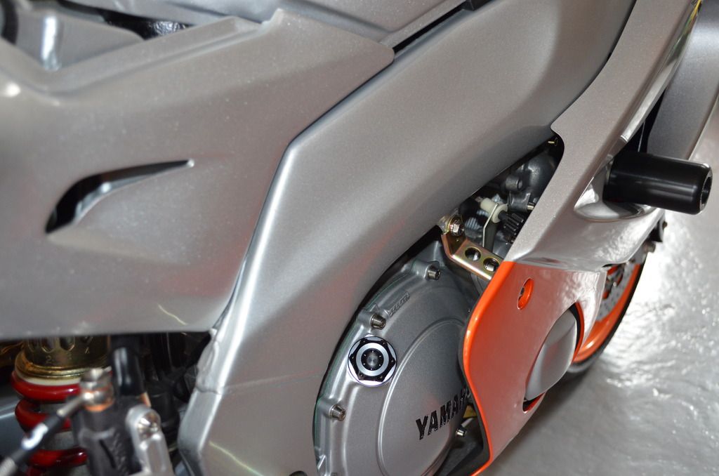

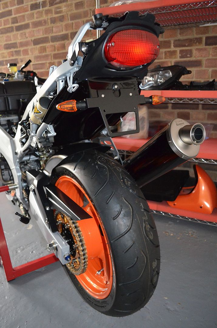

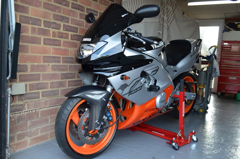

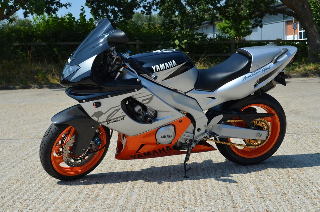

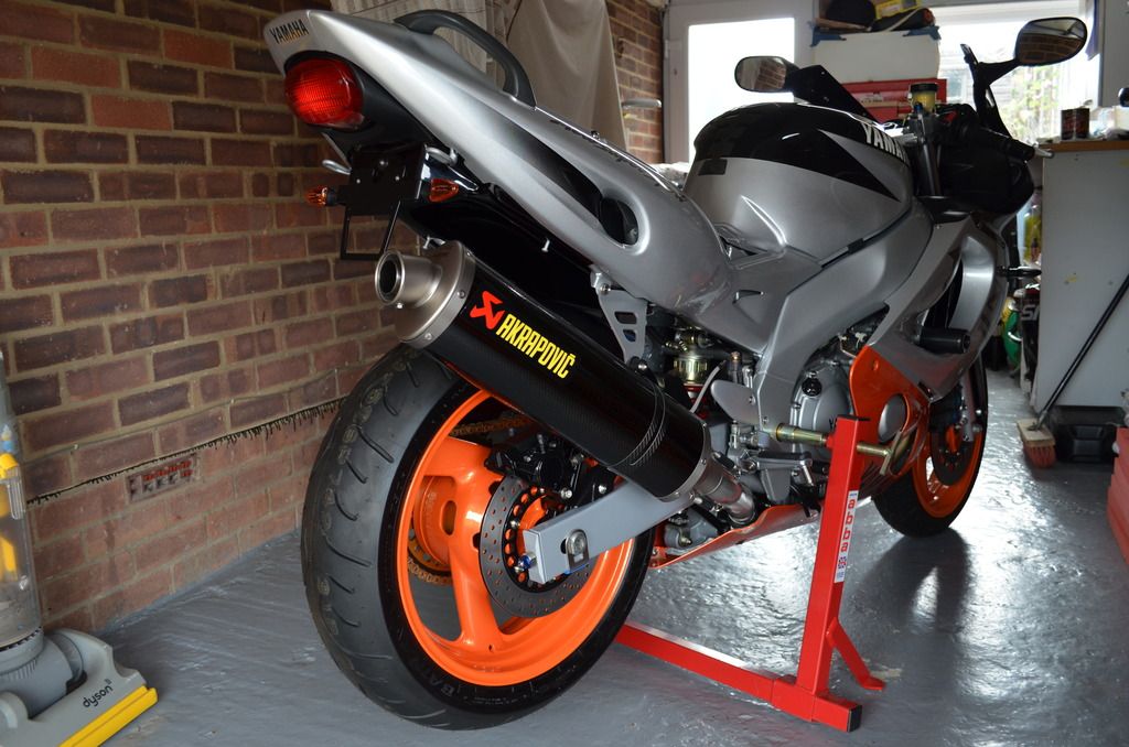

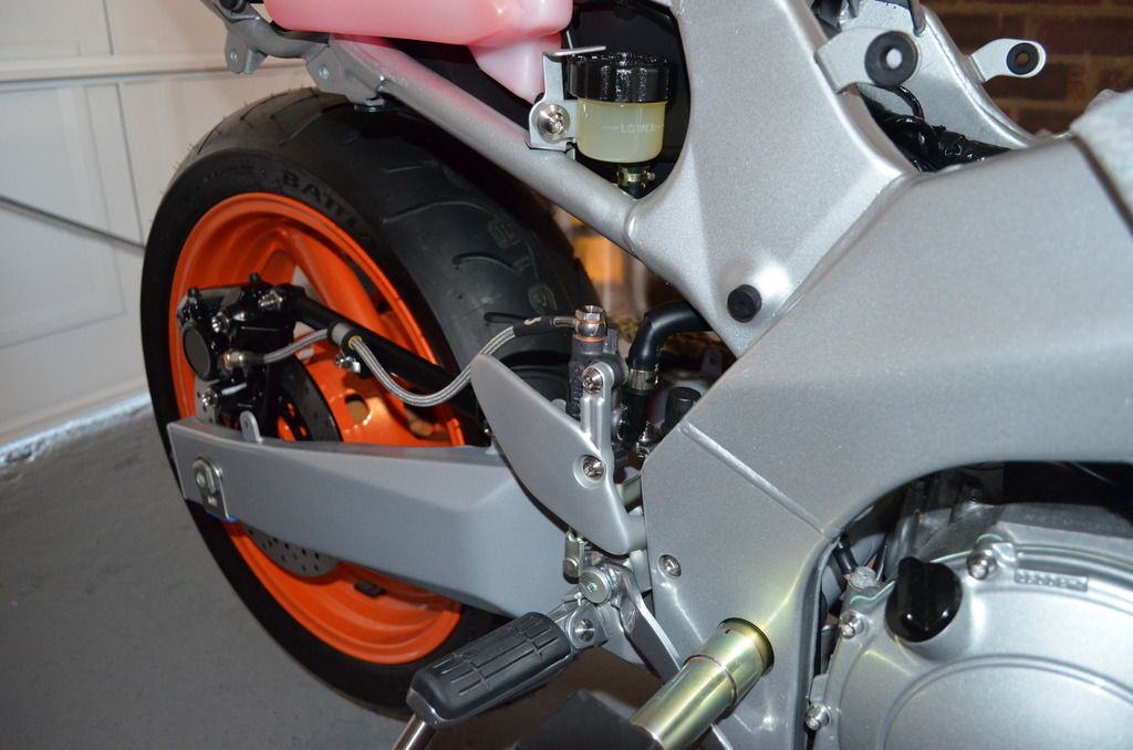

Sorry it's been a while since my last update.
The bike is finished now, see pictures below.

Thanks for cleaning it up for me Nigel.
I've fallen in love and I'm ready to buy it now
Looks lovely.....good job.
