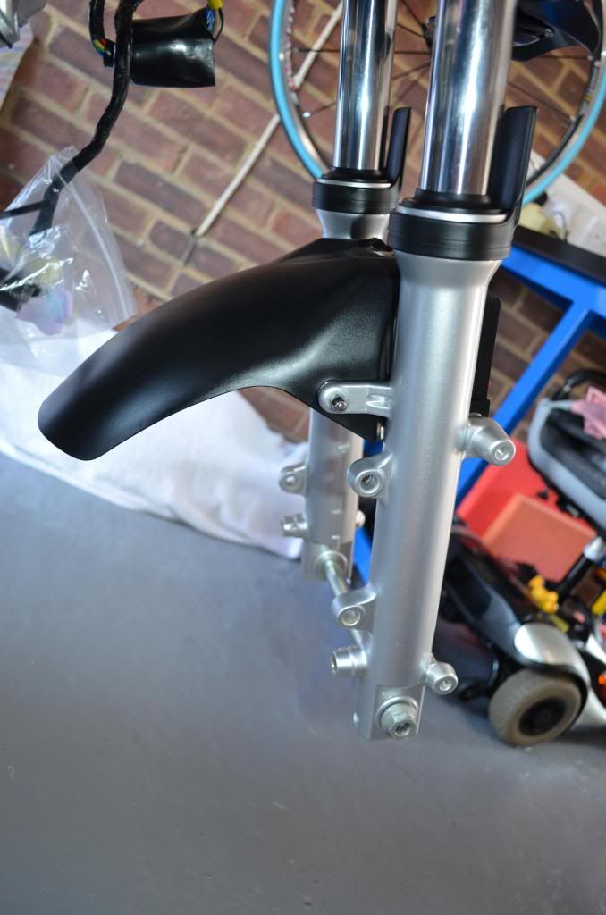

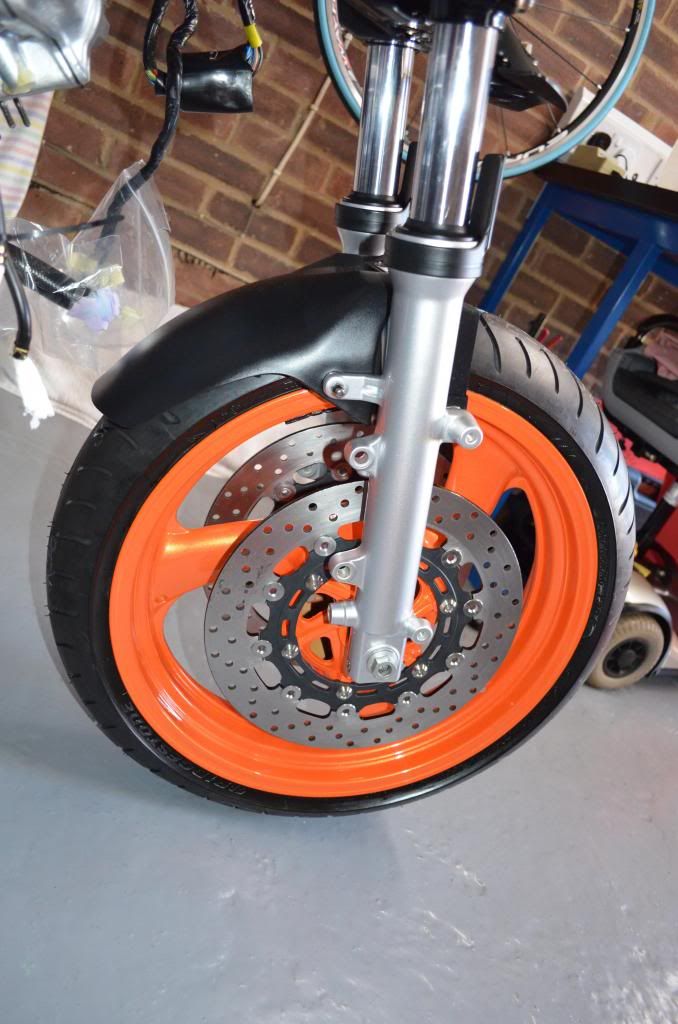

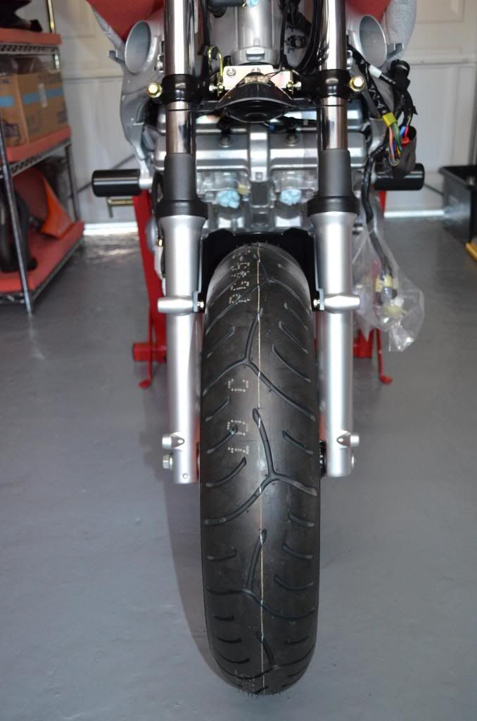

Post  Nigel T/Cat on Sun Mar 16 2014, 19:11

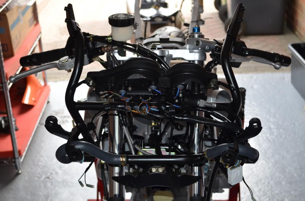

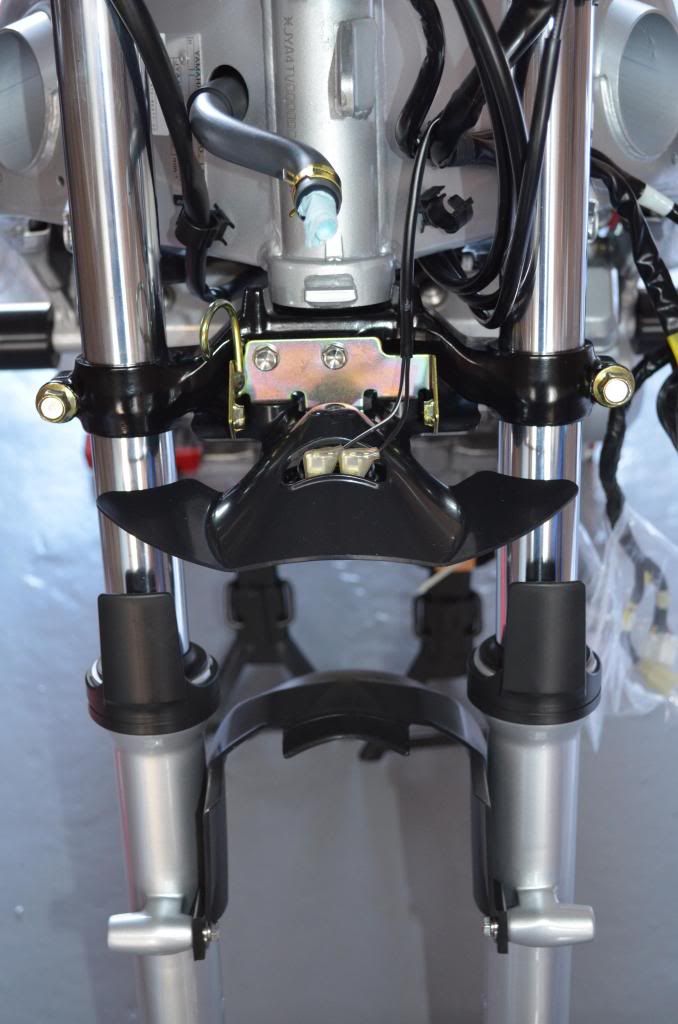

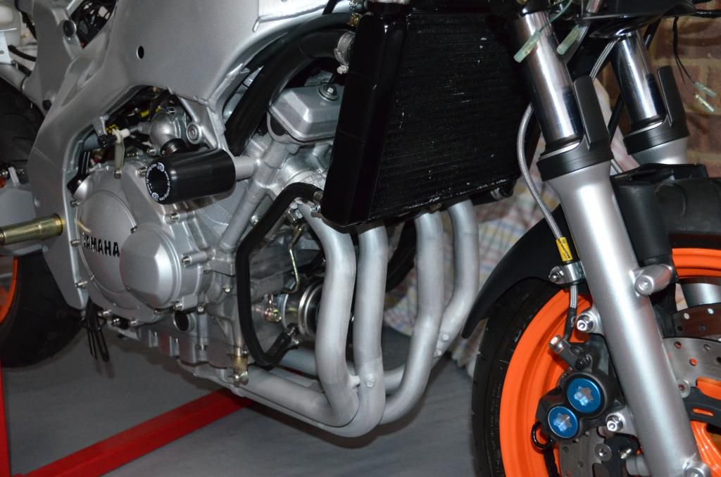

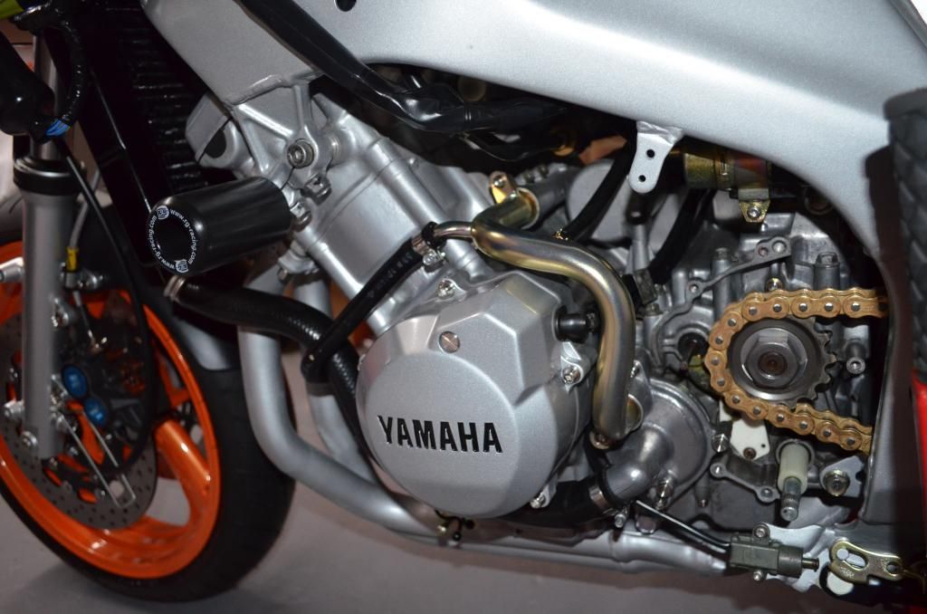

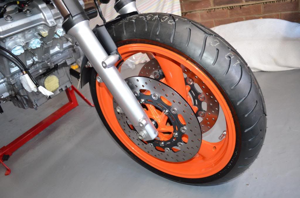

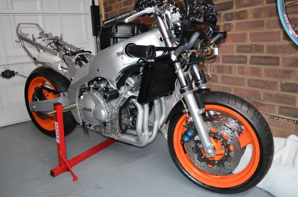

Here is an update of what I have been doing to the bike:

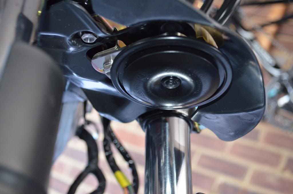

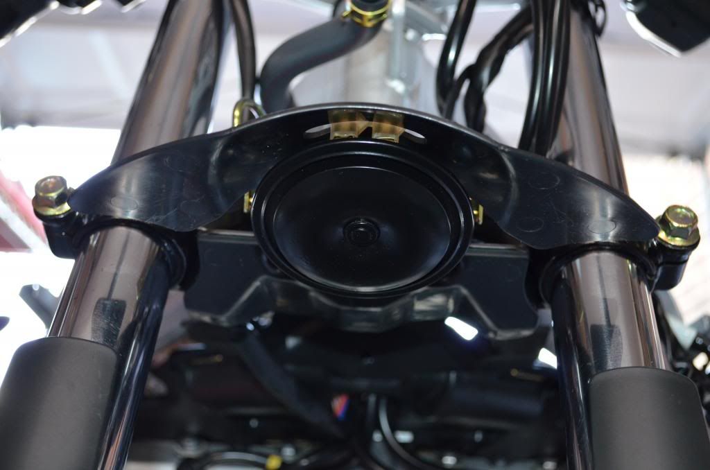

Fitted bracket to bottom yoke for horn/brake lines etc.
Made new stainless steel horn mounting plate & fitted to horn.
Fitted steering cover, & horn.
Fitted back half of front mudguard.
Cleaned up front disc’s  & fitted to front wheel with new stainless steel bolts.
Cleaned & painted speedo drive and fitted to front wheel.
Fitted front wheel with new stainless steel wheel spacer.

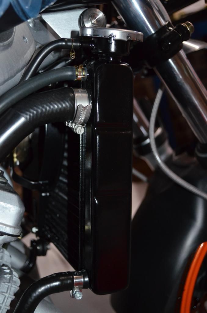

Cleaned around coils and fitted re-plated hose clips to air intake hoses.
All the stainless steel bolts have been tarted up by dgsdale and he has also made the front wheel spacer, various washers and spacers out of stainless steel. All these little touches make all the difference.
See picture below.

My god that really is attention to detail, well done amazing work.

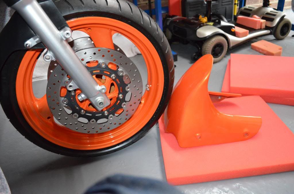

Re: Some TLC for Thundercat

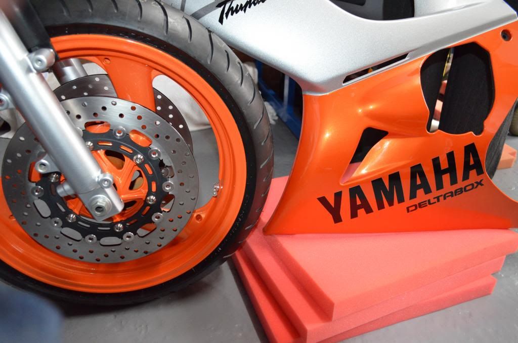

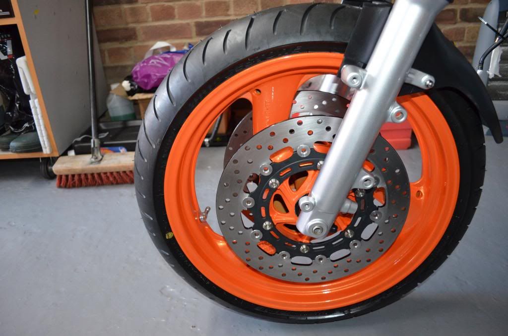

Post  Nigel T/Cat on Mon Mar 17 2014, 18:19
@Rosco wrote:Keep up the good work.
It'll almost be as nice as mine when you're finished Wink
I've heard the orange is a difficult colour to match (and keep clean).
Have you got a picture of the wheels and the orange fairing together?
What paint (code) did you use?
I've got myself 2nd hand wheels a while back and just bought 2nd hand discs on eBay tonight.
Thinking about orange but if I do that I'll need to keep her clean. Billy Whizz
I've just taken a picture of the orange wheel and fairing together, and a picture of the orange wheel and front mudguard (See Pic's Below).
The orange mudguard is not going back on the bike, as I've got a new carbon fibre one.
The paint was Kawasaki Orange Pearl Colour Code: 176. When I purchased the paint I got a White Undercoat colour code:101 a
Orange undercoat colour code:154. I purchased the paint from autopaint southampton there telephone number is 023 80406136.
The colour match of the paint is not perfect, but very close. Let me know what you think.

Post  Rosco on Mon Mar 17 2014, 23:35
Thanks for doing that.
Looks good.....black is so much easier to get away with not cleaning it though.
Struggling to decide. I'll check with my painter and pillion.

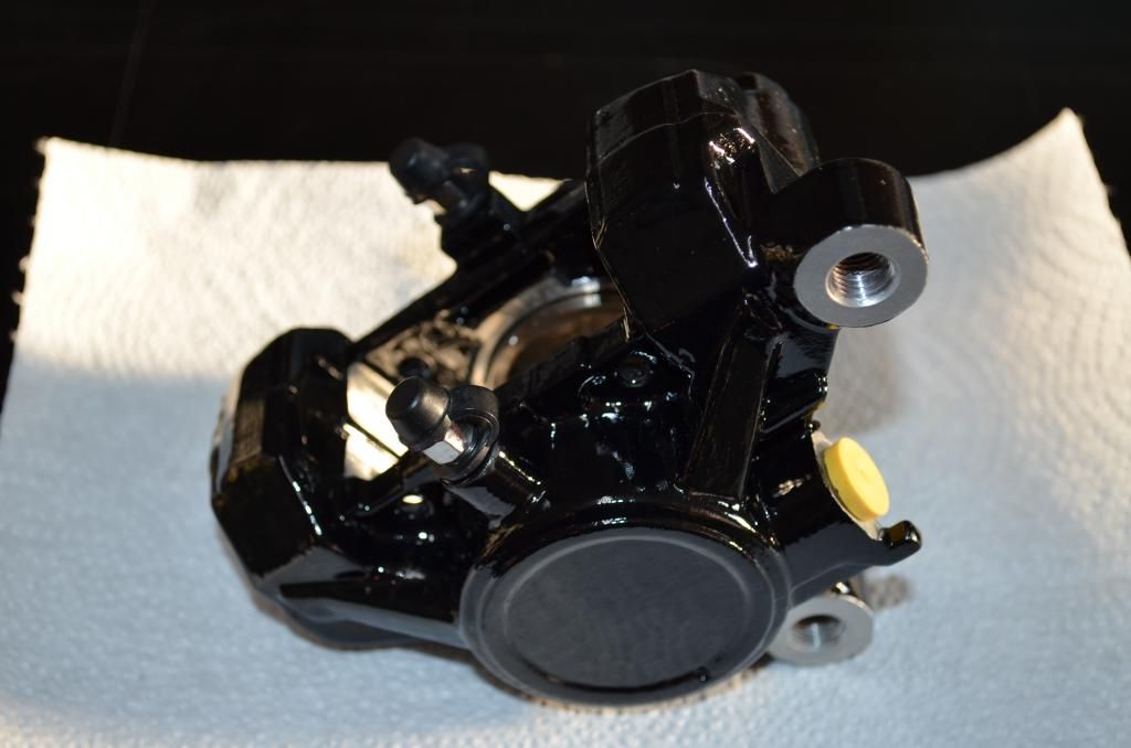

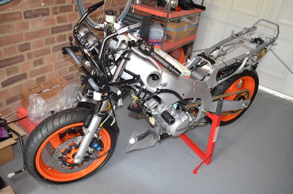

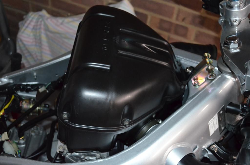

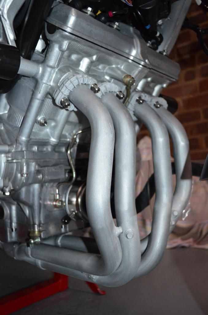

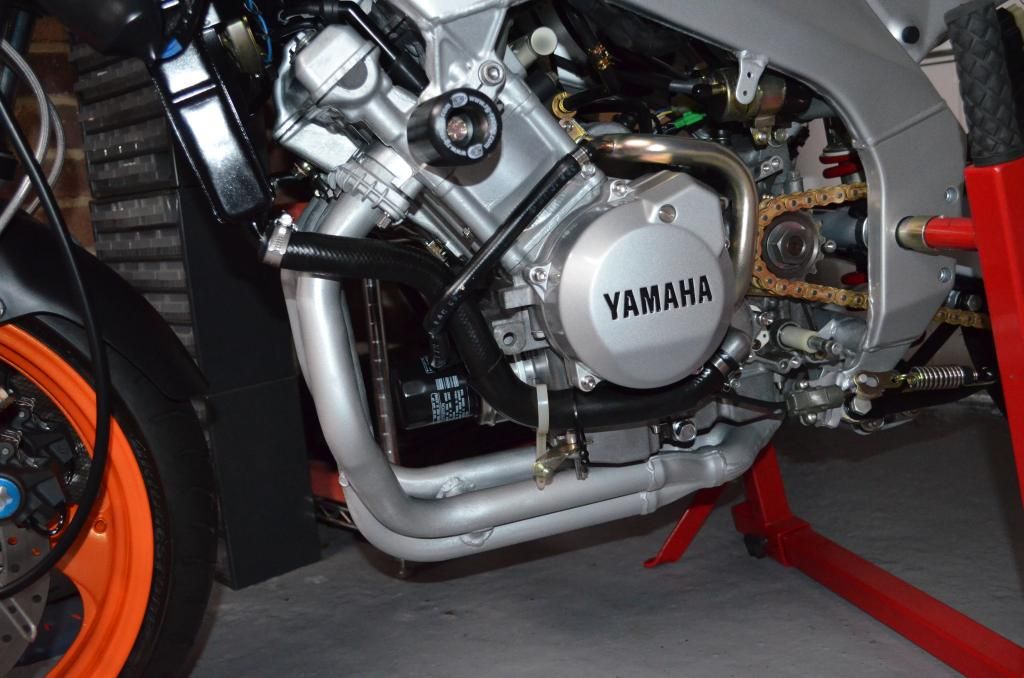

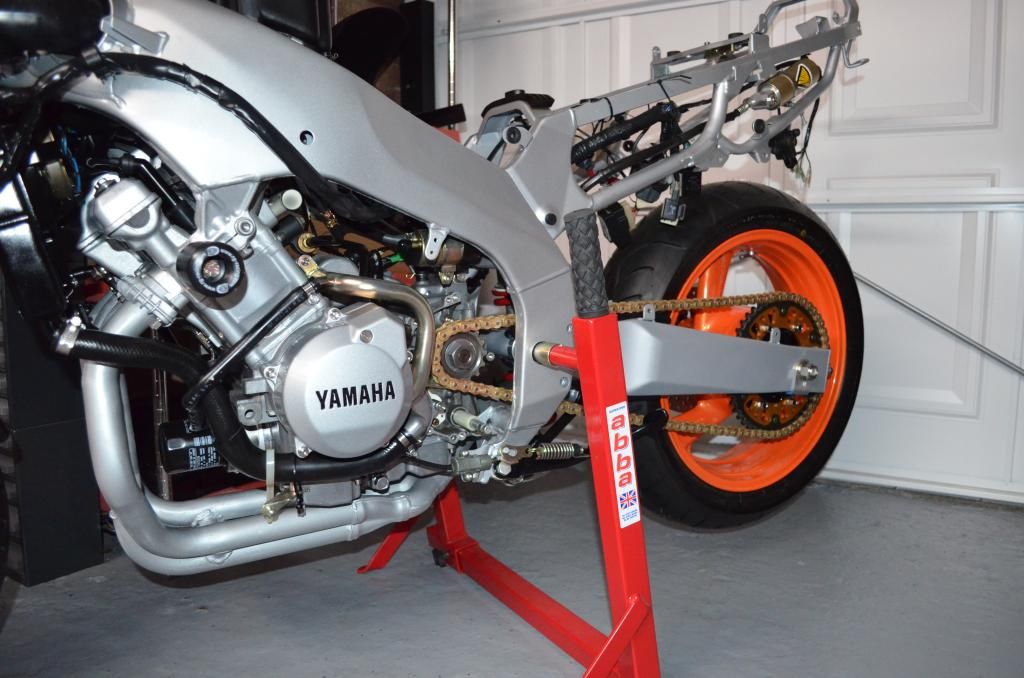

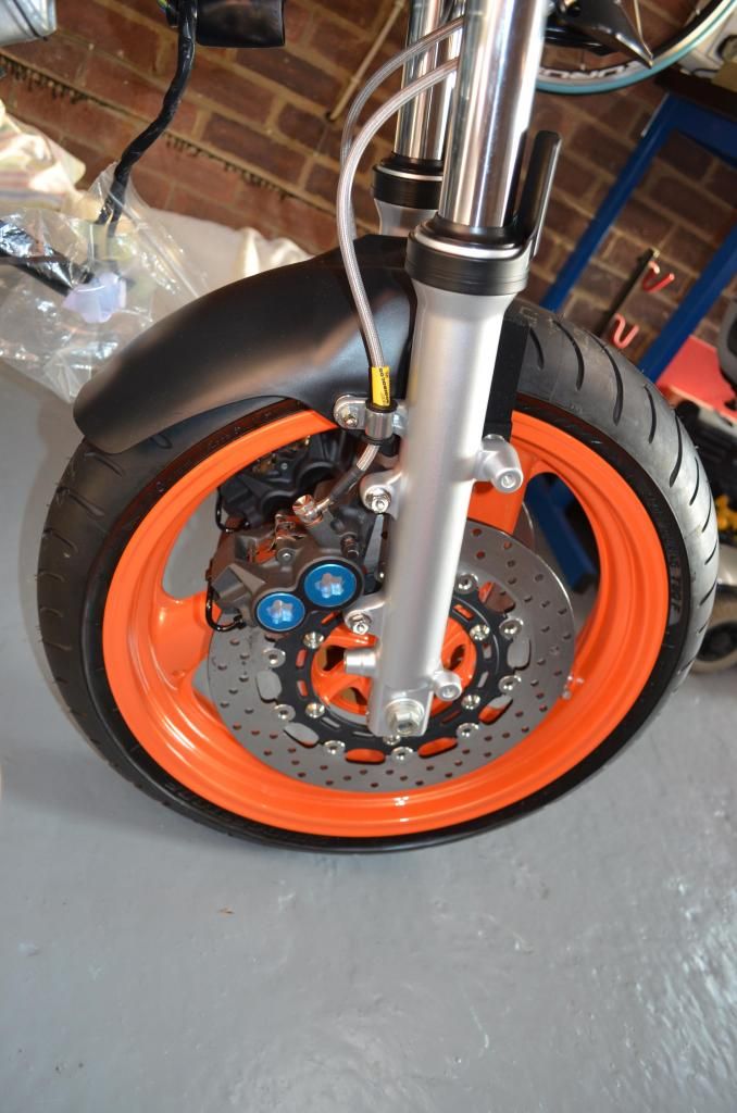

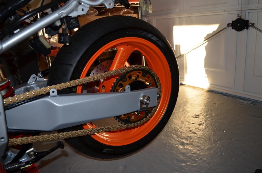

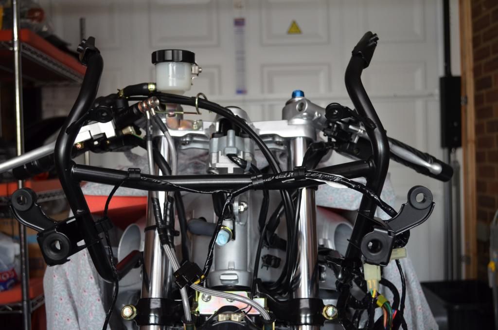

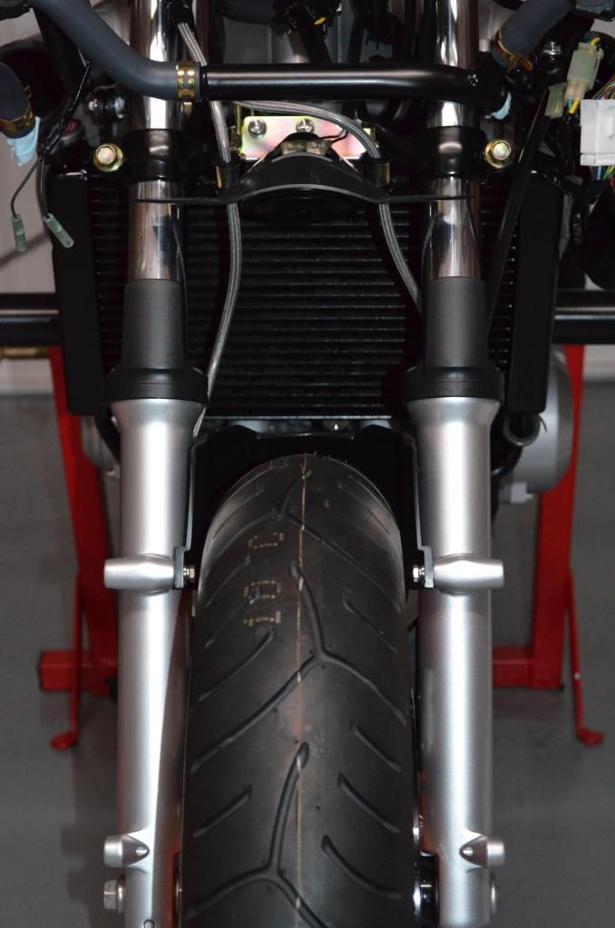

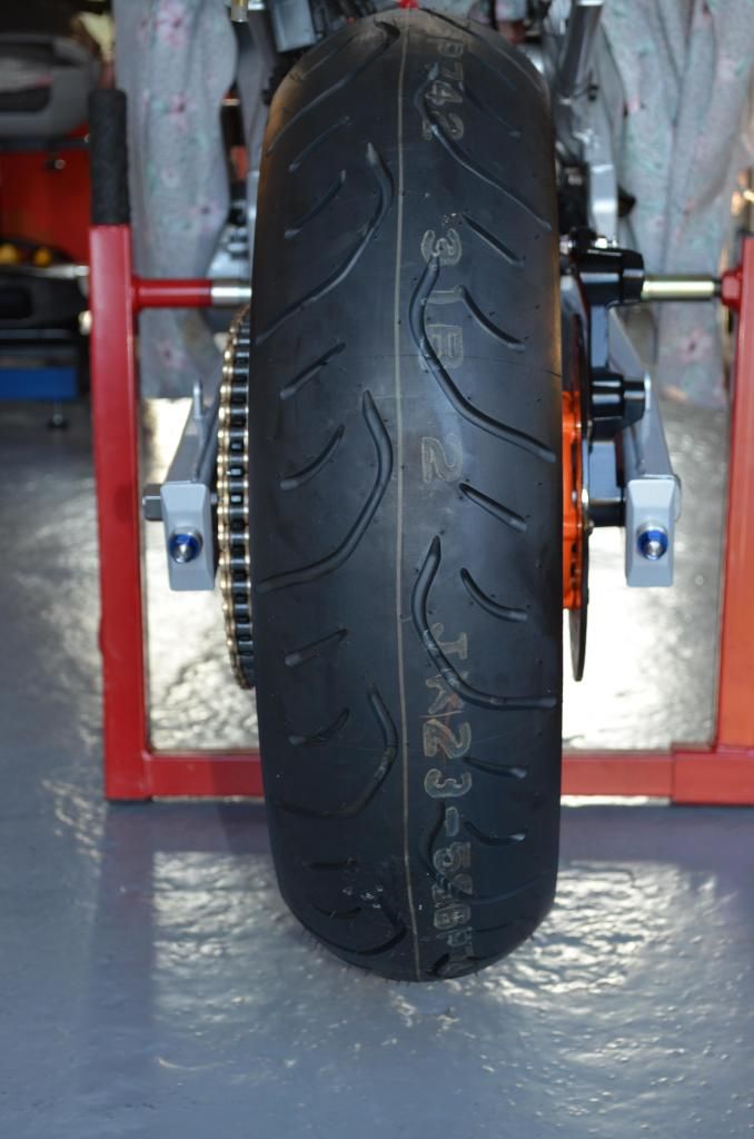

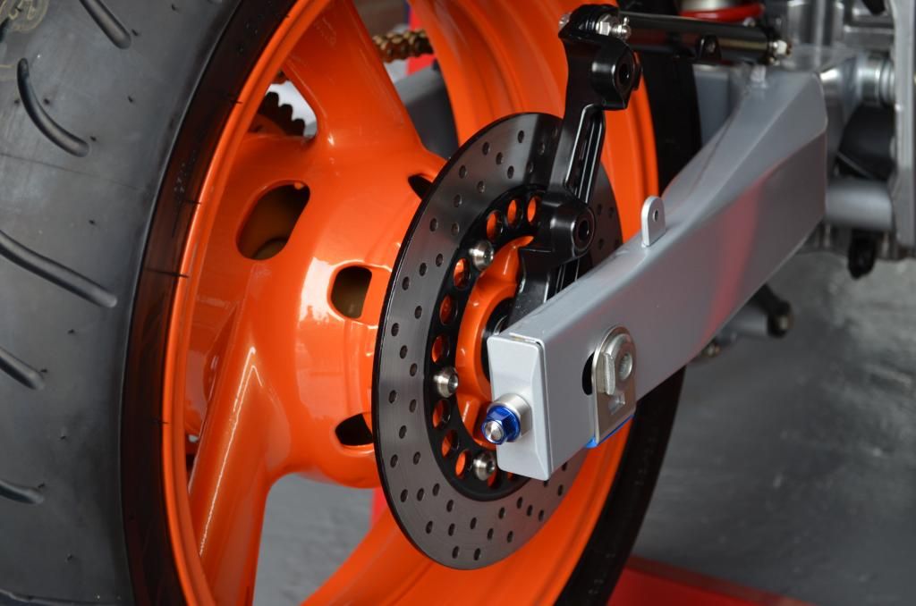

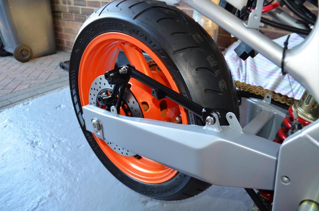

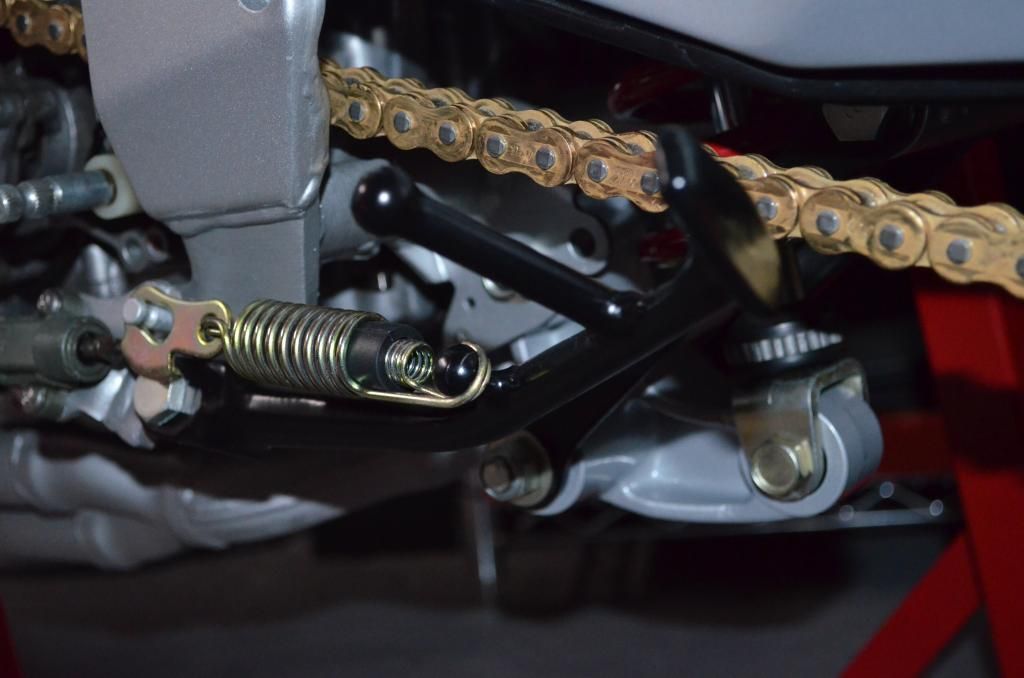

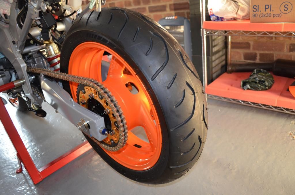

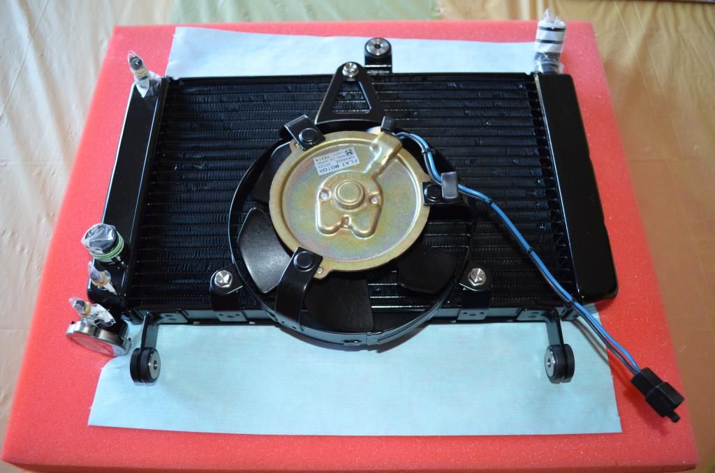

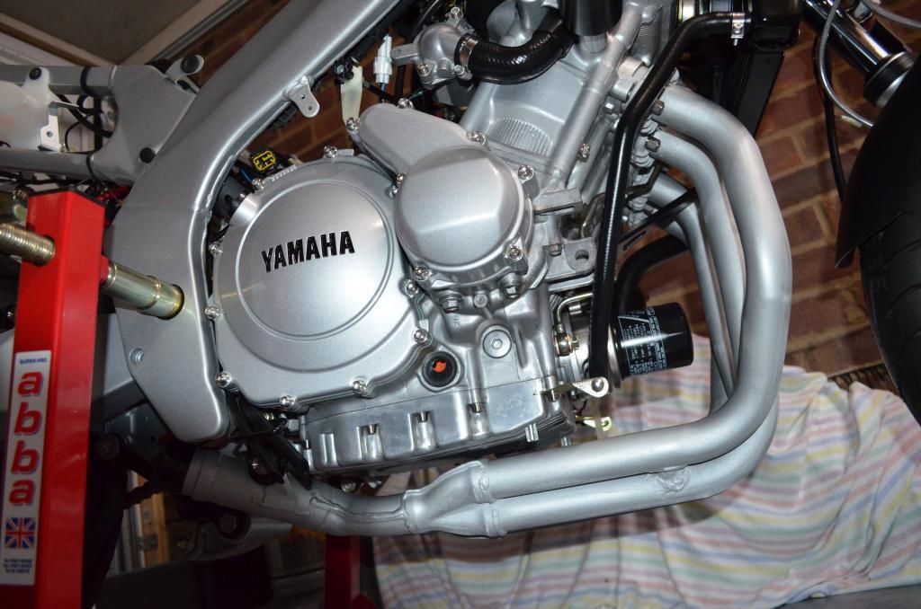

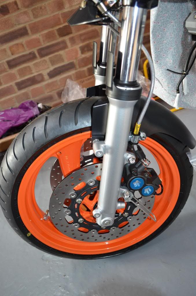

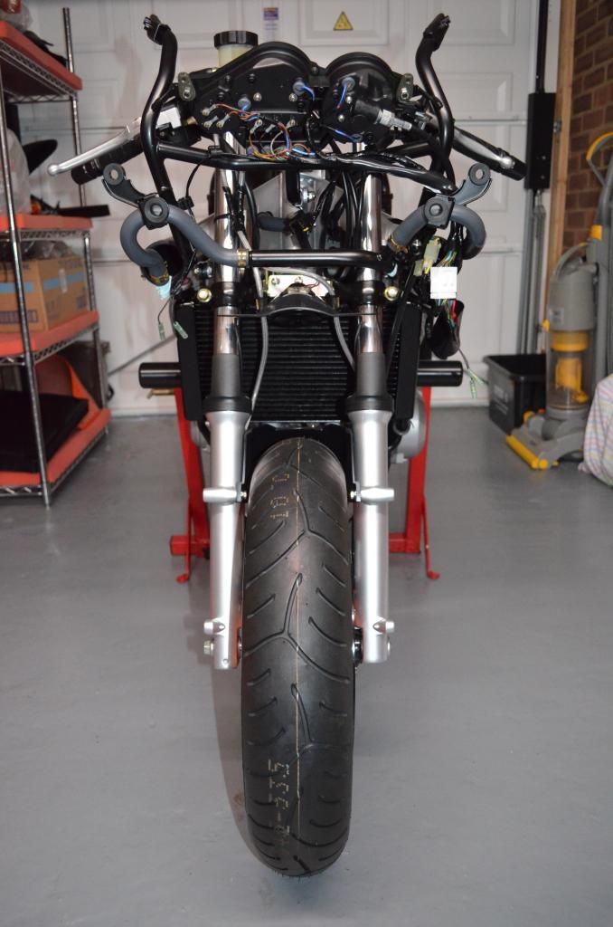

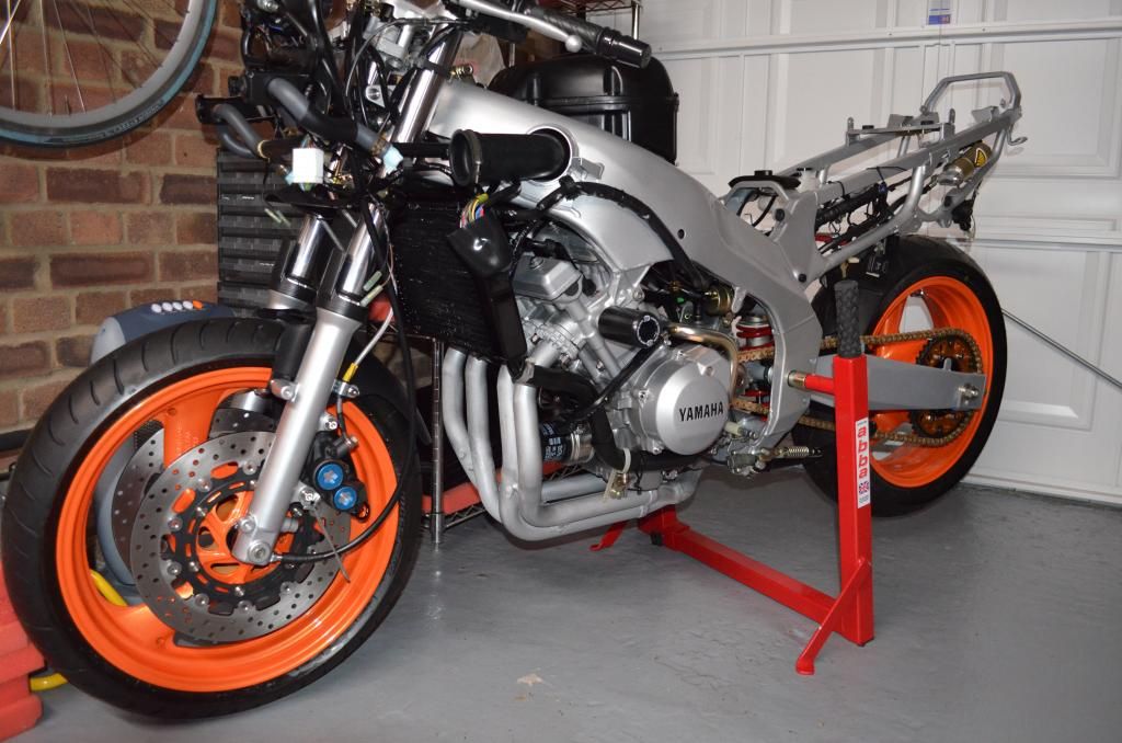

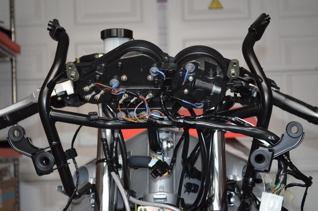

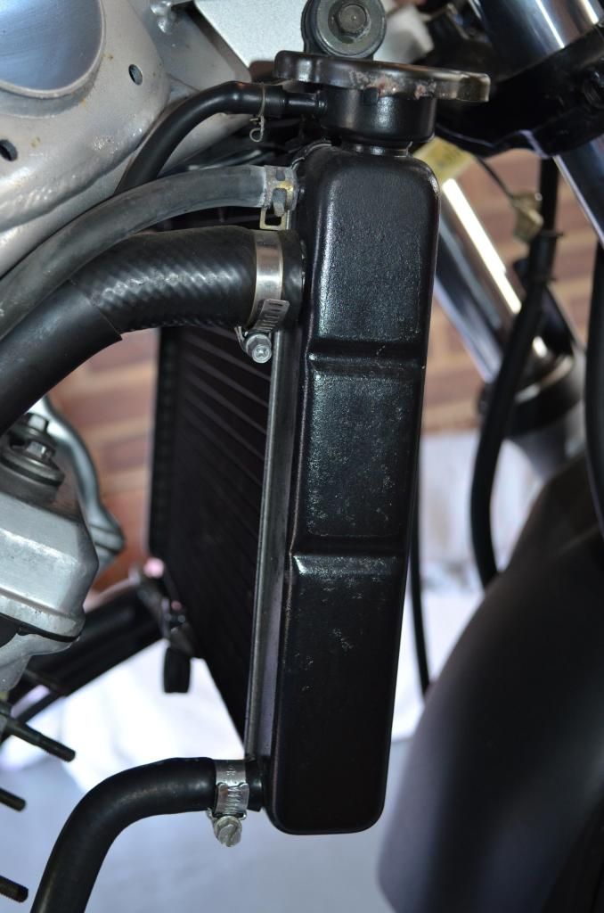

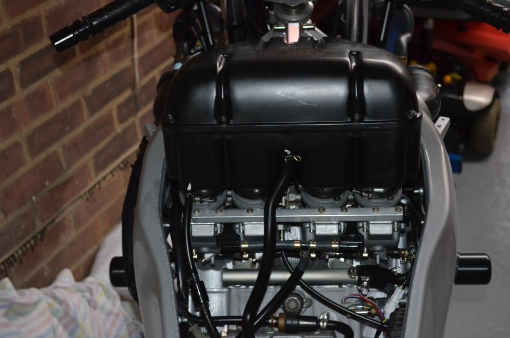

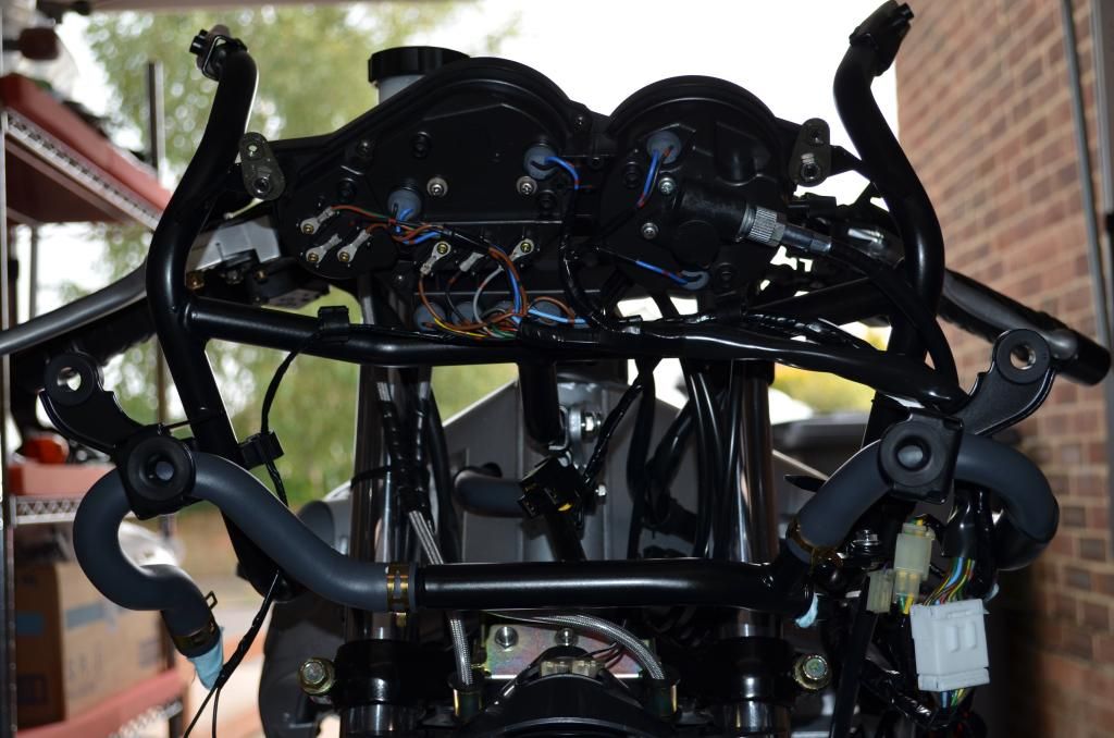

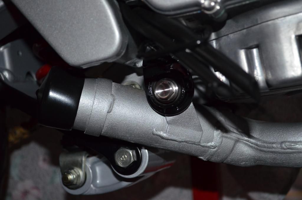

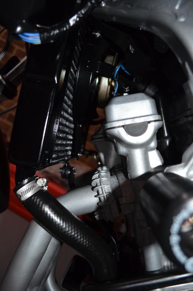

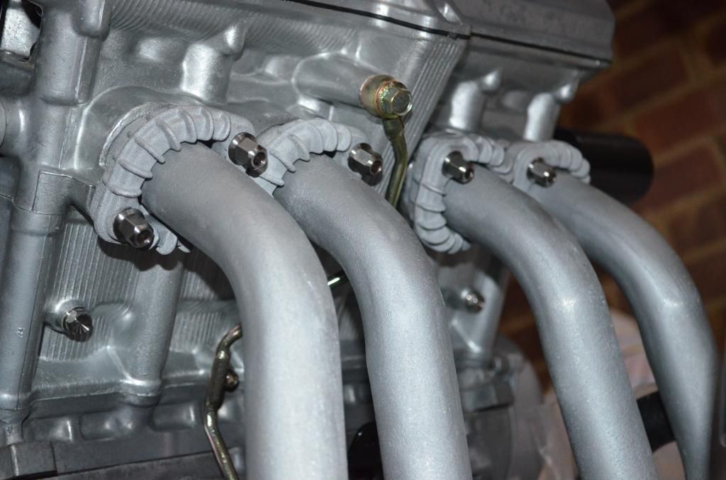

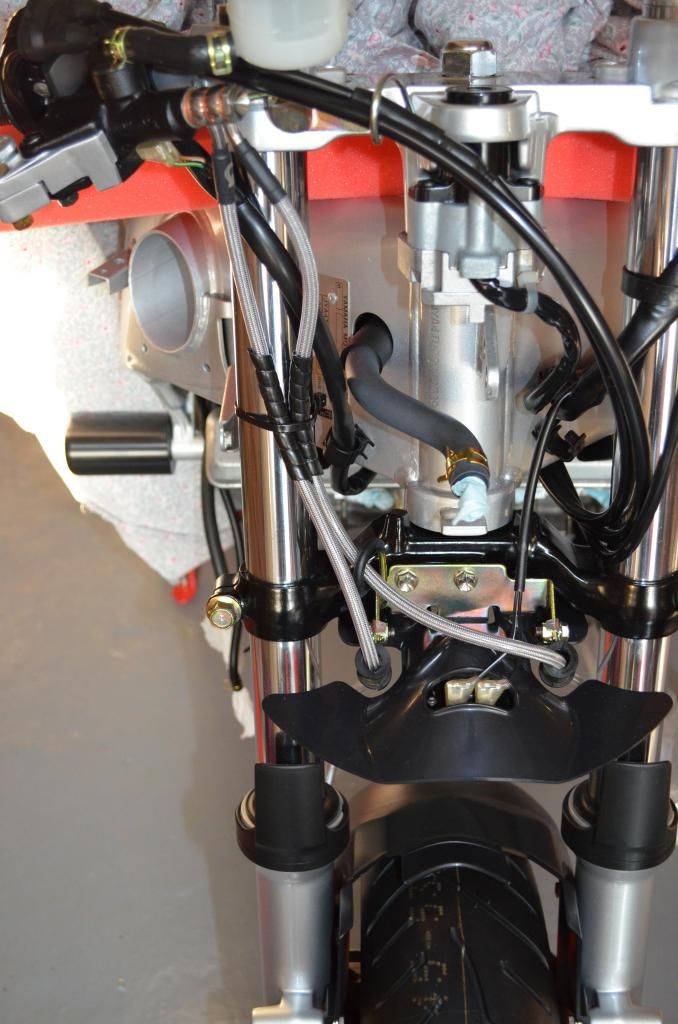

Post  Nigel T/Cat on Fri Sep 12 2014, 21:18

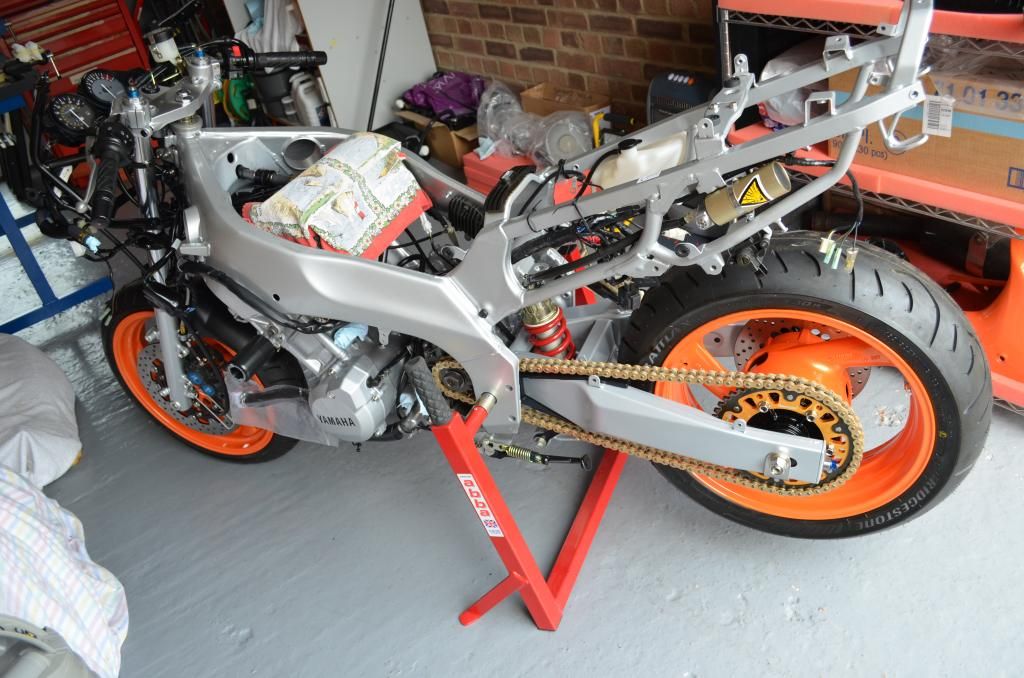

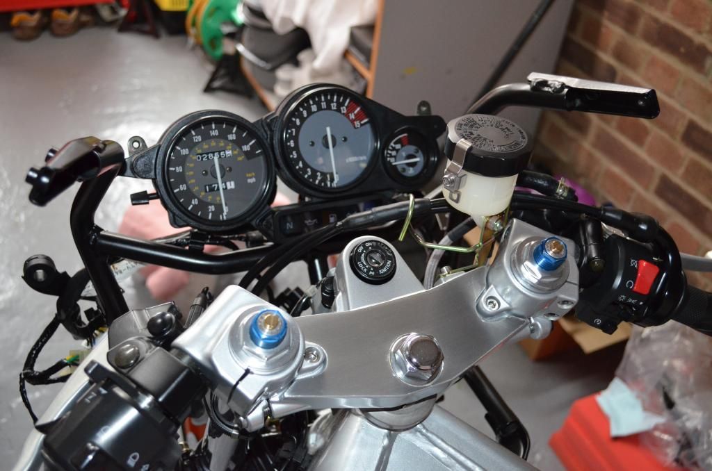

Here’s an update of what I’ve been doing to the bike:
Cleaned, paint link pipe on front brake calipers.
Fitted front brake calipers using stainless steel bolts from Probolt.
Fitted front braided brake lines.
Fitted fairing bracket, ram air pipe and instrument display.
Fitted rear wheel, chain and sprockets & side stand.
Cleaned & painted rear brake caliper.
See Pictures Below.

Here’s another update.

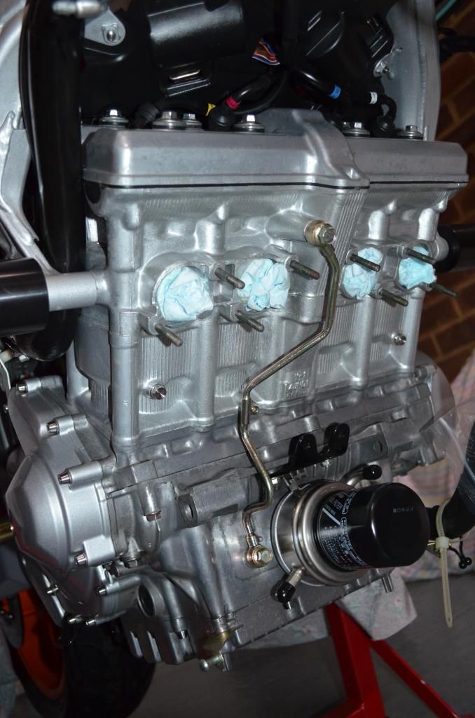

Fitted re-plated oil delivery pipe and banjo bolts.
Cleaned oil cooler & paint the back of it with silver hycote engine enamel.
Fitted oil cooler, new oil filter & filled engine with oil.
Downpipes have been hot aluminium coated, and painted with silver VHT paint.
Fitted down pipes with stainless steel nuts, washers and bolt.
Cleaned Fan & fitted to fan mounting bracket (which has been powder coated) with stainless steel nuts.
Painted the radiator with gloss black hycote engine enamel.
Fitted the fan assembly to the radiator with stainless steel bolts.
Fitted the radiator to the bike with stainless steel spacers, washers & bolts.
Fitted the hoses to the radiator with stainless steel hose clips and re-plated hose clips.
Fitted stainless steel bolts to water pump
Fitted re-plated water pipe with stainless bolts, and refitted hose from water pipe to oil cooler with stainless steel hose clips.
Cleaned air box, fitted new air filter and fitted to bike with stainless steel bolts, washer and spacer.
All stainless steel bolts, tarted up by dgsdale.
All stainless steel washers, spacers and nuts - made by dgsdale.
Here are some before and after pictures.
Before.
After.
Before.
After.
Before.
After.
