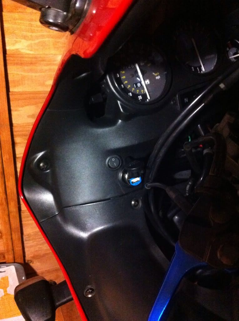

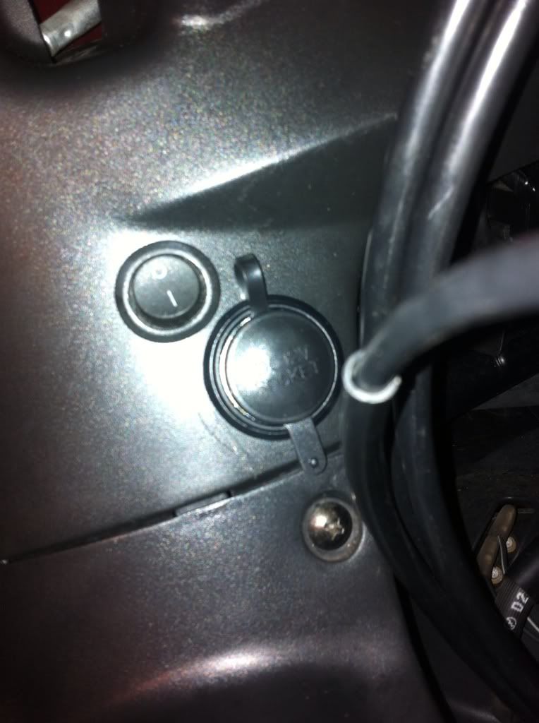

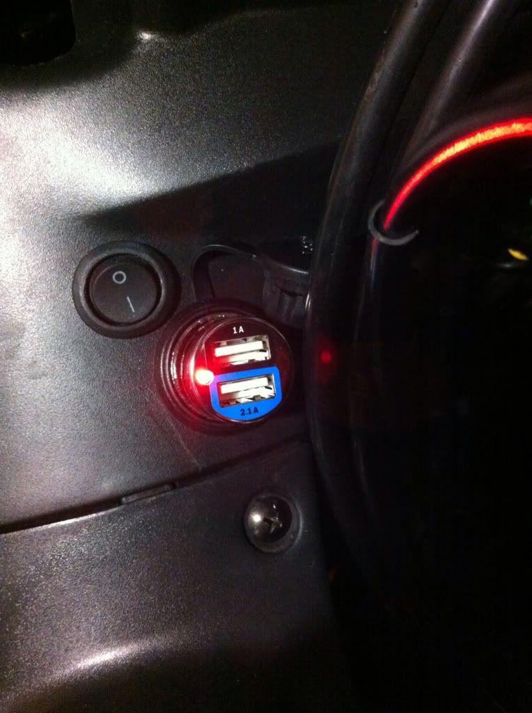

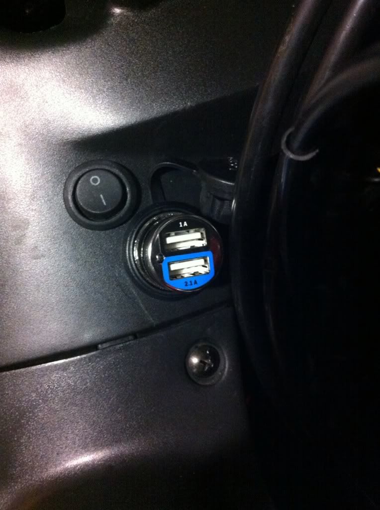

12v charging socket added
Post  'Cat-Man-Do on Mon Dec 17 2012, 02:23
Hi everybody,
Got around to installing a lighter socket to my cat earlier tonight
Little bit fiddly (mostly because the dash needs removing). Also included a switch so as not to drain my battery and bought a USB adapter to charge my iphone
Happy with the result and now keeping an eye out for a quality sat nav mount to compliment it.
See pics below
'Cat-Man-Do
Male Number of posts : 34
Registration date : 2012-11-06

Post  YZFJohn on Mon Dec 17 2012, 09:19
I fitted one on mine in the same place as you and the problem I had was with vibration making the plugs come out. A little bit of insulation tape around the head of the plug gave a firmer fit and prevented it from happening again. Hope that may help you.
Male Number of posts : 1681
Re: Leeds T'Cat - few pics
Post  'Cat-Man-Do on Mon Dec 17 2012, 13:15
Not sure about the sweatband thing Weasley, some people say its to prevent any brake fluid leaking out and ruining your paintwork... I removed mine coz they soon look weather worn and naff and it defeated the point of me putting a nice shiny blue Yamaha cap on my bike...might as well stick a smelly old sock on there!
Thanks John, but I had some trouble getting the switch and socket into their respective holes (vvvvery snug) they won't be coming loose anytime soon! wink thumb up
'Cat-Man-Do
Post  biscut on Mon Dec 17 2012, 14:09
ok, might be a silly question but did you have to drill holes to fit both of those or are there holes there already for this mod ? I would have a look on my bike to try and answer my own question but its still stuck in Southend till the 29th (weather permitting) so cant look...
biscut
3Silver
3Silver
Male Number of posts : 217
Hobbies : IT Geek
Humour : dark and perverted
Registration date : 2012-09-20
Post  'Cat-Man-Do on Mon Dec 17 2012, 14:15
Had to drill the holes myself, quite tricky unless you have 3/4 inch and 1inch diameter drill attachments (which I don't)....
'Cat-Man-Do
